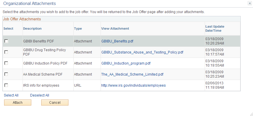

 HRS_OFF_SELATC_SEC  |
 Select items from your organization's library of existing attachments, and attach them to the job offer.  |

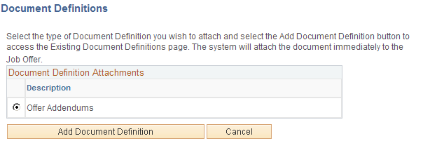

 HRS_OFF_SELDOC_SEC  |
 Add document definition attachments to an offer.  |

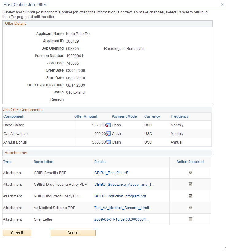

 HRS_OFFER_SEND_SEC  |
 Post a job offer to Candidate Gateway.  |

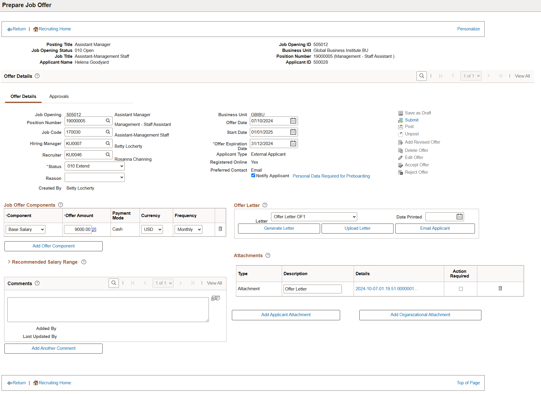

Use the Prepare Job Offer page (HRS_APP_RCMNT) to create and manage a job offer.
Navigation:
Select on any of the following pages:
Manage Job Opening page: Applicant tab
Manage Applicant page: Applicant Activity page: Current Status section
Search Applications
Manage Application
When an offer already exists, you can also click the Edit Offer link on the Manage Application page: Interview tab.
This is the first of two examples illustrating the Prepare Job Offer page. In this example, the offer has been through the approval process, so the offer information is on an Offer Details tab and the approval information is on an Approvals tab. If approvals are not active, the page does not have tabs.

Offer Details
Note that the Offer Details section is a scroll area for accessing all of the offers that exist for the current applicant and job opening. Typically, you do not create additional offers unless the original offer has been rejected or withdrawn. This ensures that there is not more than one offer extended at a time.
Field or Control  |
Description  |
Job Opening  |
 Displays the job opening ID and posting title. If the offer was created without the context of a job opening, the field is editable so that you can supply a job opening ID.  |
Position Number  |
 This field appears only if the system is configured for full or partial position management. Under full position management, a position number is required. Under partial position management, it is optional. Initially, this field displays the position number, if any, that is associated with the job opening. If the job opening is associated with multiple positions, you can select any of the associated positions. If the offer is not associated with a job opening, or if it is associated with a continuous job opening that doesn't have position data, you can manually enter a value (and must do so under full position management).  |
Job Code  |
 Initially, this field displays the job code that is associated with the job opening. If the job opening is associated with multiple jobs, you can select any one of the associated job codes. If the offer includes a position number (required under full position management), the system enters the associated job code. If the offer is not associated with a job opening, then you must manually enter either a job code or position number. If the job opening is a continuous job opening without job code data, then the job code is optional. However, a job code will be required before you can prepare the applicant for hire.  |
Hiring Manager  |
 The default value is the primary hiring manager for the job opening. You can override this value if necessary.  |
Recruiter  |
 The default value is the primary recruiter for the job opening. You can override this value if necessary.  |
Status  |
 Although you can configure offer statuses on the Recruiting Status and Reason Page, Oracle delivers a complete set of statuses and recommends that you use the delivered status codes. Generally you can let the system set the value based on the actions you perform. However, it is possible to manually select an offer status except for these situations:
 The delivered statuses are:
Reason  |
 If your organization has set up reasons for a particular status, you can select a reason for putting the offer in a status. For example, reasons for the Offer Rejected status might include Base Salary, Benefits, or Personal.  |
Created By  |
 Displays the name of the person who created the job offer.  |
Business Unit  |
 Displays the business unit that is associated with the job opening. If the offer was created without the context of a job opening, the field is editable so that you can supply a business unit.  |
Offer Date  |
 Enter the date the offer is effective. The default is the current date.  |
Start Date  |
 Enter the date that the applicant is to report for work. This date cannot be before the offer date.  |
Works Council ID  |
 This field appears if job offers require works council approval. This occurs if the Optional Works Council approval option is selected on the Recruiting Installation - General Page and if the job opening template includes the Works Council section. The default value is the works council ID associated with the job opening.  |

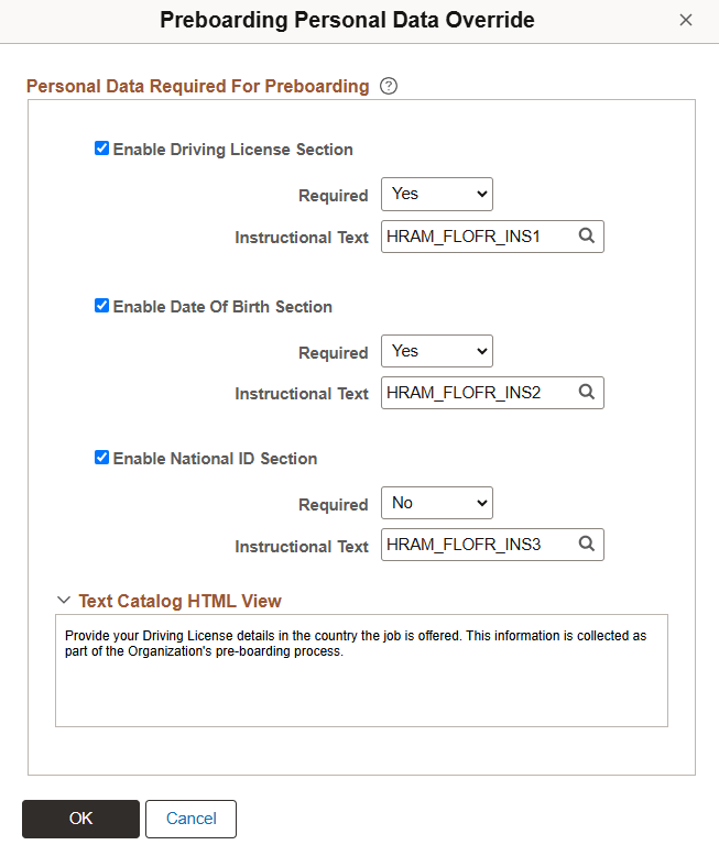

          Personal Data Required for Pre-Boarding  |
          Select to open the Preboarding Personal Data Override modal and override the configuration for the Personal Data sections on the online job offer page for the applicant. This allows the recruiter to change the configuration defined for preboarding in the Recruiting Installation – Applicants Page. Note: This link is displayed only if the Notify Applicant is selected.  |
This example illustrates the Preboarding Personal Data Override modal window.
          Field or Control  |
          Description  |
          Enable Driving License Section  |
          Select to display the Driving License section under the Personal Data section on the online Job Offer page.  |
          Enable Date Of Birth Section  |
          Select to display the Date Of Birth section under the Personal Data section on the online Job Offer page.  |
          Enable National ID Section  |
          Select to display the National ID section under the Personal Data section on the online Job Offer page.  |
          Required  |
          Select Yes to make the section (Driving License, Date of Birth, and National ID) as mandatory on the job offer page. When a section is mandatory, the applicant must fill the section fields before submitting the personal data.  |
          Instructional Text  |
          Select the instructional text catalog for the Personal data sections such as Driving License, Date of Birth, and National ID.  |
          Text Catalog HTML View  |
          Displays the text catalog value for the selected instructional text. For example, if you select a text catalog (Sub ID as CG) from the prompt for the instructional text under Date of Birth, the Text Catalog HTML View displays the value for that text catalog. This helps the recruiter to view the text displayed under the Date of Birth section of Personal Data on the online job offer page.  |

Field or Control  |
Description  |
Type  |
 Identifies the attachment as one of these:
Description  |
 Enter identifying information for the document. The default description for offer letters is Offer Letter.  |
Details  |
 Click to display the attachment. The link text is the file name for file attachments and the URL for URL attachments. Notes, which are added as document definitions, display the note subject.  |
Action Required  |
 Select this check box for any items that the applicant must complete and return if the offer is accepted. In Candidate Gateway, an icon appears next to these documents, along with instructions to review the marked documents.  |
 Click this icon to delete an attachment. Deleting an offer letter attachment does not remove the applicant note that was automatically created when the letter was generated. The note continues to display the offer letter as a note attachment. However, the attachment cannot be opened from the note. A warning message that appears when an offer letter is deleted recommends that the user manually modify the related applicant note.  |
Add Applicant Attachment  |
 Click to display a Choose File dialog box, where you select a local file to upload. This button is active only when the offer is editable.  |
Add Organizational Attachment  |
 Click to display the Organizational Attachments page, where you can select existing attachments (file attachments or URLs) to add to the offer. The attachments that appear on the Organizational Level Document page are context-dependent. For example, if an attachment is valid only for a particular business unit, then it is available only for job offers in that business unit. This button is active only when the offer is editable.  |
Add Document Definition  |
 This button appears only if your organization has enabled document definitions for offers, and if there are document definitions that are valid in the current context. This is not common. Click this button to access the Document Definitions page, where you choose document definitions to add to the offer.  |
Use the Organizational Level Documents page (HRS_OFF_SELATC_SEC) to select items from your organization's library of existing attachments and attach them to the job offer.
Navigation:
Click the Add Organizational Attachment button on the Prepare Job Offer page.
This example illustrates the Organizational Level Documents page.
Job Offer Attachments
The list of available attachments and URLs is context-sensitive. For example, certain attachments might be valid for some business units but not others.
Field or Control  |
Description  |
Select  |
 Select one or more documents that you want to attach to the job offer.  |
Attach  |
 Click to attach the selected documents to the job offer and return to the Prepare Job Offer page.  |
Cancel  |
 Click to close the dialog box without adding any attachments to the job offer.  |
Use the Document Definitions page (HRS_OFF_SELDOC_SEC) to add document definition attachments to an offer.
Document definitions are not typically used in recruiting.
Navigation:
Click the Add Document Definition button on the Prepare Job Offer page.
This button is hidden when there are no valid document definitions for this context.
This example illustrates the Document Definitions page.
Document definitions are part of the PeopleSoft HCM common attachments framework. They are empty placeholders where users can add file attachments, URLs, or text notes. Because recruiters can add files attachments directly to the offer, and they can incorporate URLs and text notes into the offer letter, document definitions are not typically used in the context of job offers.
Field or Control  |
Description  |
Document Definition Attachments  |
 This grid lists document definitions that are valid for the context of the job opening. Select the type of document definition that you want to add to the offer.  |
 Click to access the Existing Document Definitions page for the selected document definition. Then select and attach preexisting document definition attachment or create and attach new ones.  |
Use the Post Online Job Offer page (HRS_OFFER_SEND_SEC) to post a job offer to Candidate Gateway.
Navigation:
Click the Post link on the Prepare Job Offer page.
This example illustrates the Post Online Job Offer page.
Review the offer details on this page, then click the Submit button to post the offer.
When the offer is posted, the system generates a Candidate Gateway notification, sends an email to notify the applicant of the job offer, and creates a contact note.
