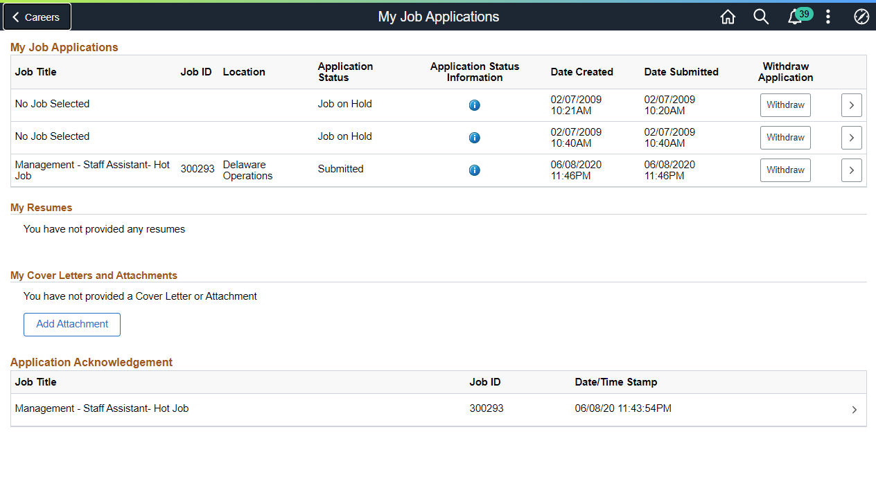

Applicants use the My Job Applications page (HRS_CE_ACTVTY_FL) to:
Review summary information about applications, resumes, and attachments.
Withdraw applications.
Add and remove attachments that aren’t associated with an application.

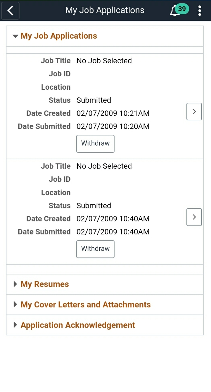

This example illustrates the My Job Applications page as viewed on a desktop.
This example illustrates the My Job Applications page as viewed on a smartphone
My Job Applications
This grid lists an applicant’s submitted and unsubmitted applications.
Field or Control |
Description |
Job Title |
This field displays the job posting title unless the applicant initiated the application as a multi-job application. In this case, the field displays the text Multiple Job Application. Note: Multiple Job Application refers only to applications where the applicant explicitly chose to include multiple jobs in a single application. If a recruiter uses Talent Acquisition Manager to link an applicant to additional jobs, those jobs are technically added to an existing application. But although the application now has multiple jobs, each job that was linked using Talent Acquisition Manager appears in a separate row in this grid in Candidate Gateway, and each row in the grid shows the job posting title in the Job Title field. |
Job ID |
Displays the job opening ID for the application, or displays the word Multiple if the application is for multiple jobs. |
Location |
Displays the primary recruiting location for the job. If the application includes multiple jobs, this column displays a dash. |
Application Status |
The Application status is Submitted if the application has been submitted. Note: The system does not update this status as the application moves through the recruiting process. Even if the application is rejected or the job opening is filled, the status remains Submitted. The Application status is Not Eligible if an applicant failed prescreening for all job openings and was not allowed to continue the job application. The Application status is Not Submitted if the application was saved for later and the applicant is able to continue with the job application. The Application status is Withdrawn if the disposition is 130 Withdrawn. This is the disposition that the system assigns when an applicant or a recruiting user withdraws the application. However, if an unsubmitted application is withdrawn, it is logically deleted and disappears from the My Job Applications grid entirely rather than appearing with a Withdrawn status. Note: For Multiple Job Application, the statuses of Not Eligible and Not Submitted will be shown. |
Application Status Information |
Lists the application statue information. |
Review the application status. |
Date Created |
Displays the date and time that the application was started, regardless of whether it was submitted on that date. |
Date Submitted |
Displays the date and time that the application was submitted. This column is blank for applications that have not been submitted. |
Date Withdrawn |
Displays the date and time that the application was withdrawn. This column is visible only if at least one application is in Withdrawn status. |
Withdraw Application |
An applicant clicks the Withdraw button in this column to withdraw an application. If the application (or at least one job in a multi-job application) is in a disposition that does not allow applicant withdrawal, a message informs the applicant that withdrawing the application is not allowed. Otherwise, the application is withdrawn. Note: For submitted multiple job applications, based on the site set up, applications will be broken down into individual applications. Once the ‘Split Multiple Jobs’ check box is selected on the Site Setup page, the applicants can view the status of each submitted application and withdraw applications individually. For drafted Multiple Job Applications, this setting is not applicable. Drafted multiple job applications will not be shown separately and cannot be withdrawn individually. Clicking the Withdraw button has different results depending on the type of application:
The withdrawal process is discussed in more detail earlier in the Understanding Application Withdrawal section of this topic. |
If the application has been submitted, clicking this button displays the Application Summary Page. If the application is unsubmitted, clicking this button opens the application so that the applicant can continue. |

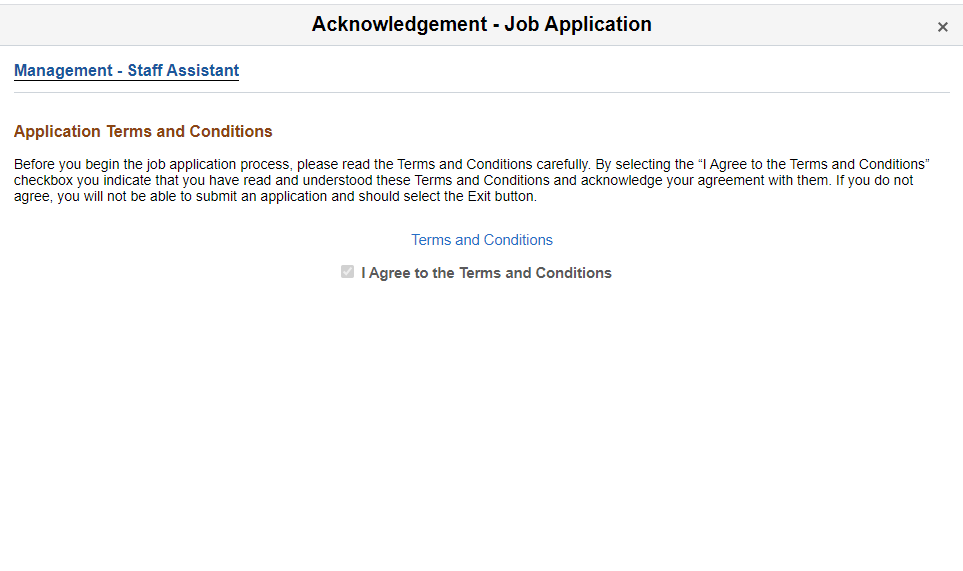

Application Acknowledgement
The Application Acknowledgement section displays all the application acknowledgements that the user has accepted. This section is available only if Acknowledgement is enabled in the Site setup page or if the applicant has as least one acknowledgement. This is only for the acknowledgements created using the Acknowledgement Framework. The grid has the following details:
Field or Control |
Description |
Job Title |
The job titles for which the application acknowledgement were accepted. |
Job ID |
The Job IDs for which the application acknowledgement were accepted. |
Date/Time Stamp |
The time at which the acknowledgements were accepted. |
Note: For the submitted Multiple Job Application, if the ‘Split Multiple Jobs’ is selected on the Site Setup page, the applicant can view the job applications separately.
Select the application acknowledgement row to view the details of the acknowledgement.
This example depicts the application acknowledgement details

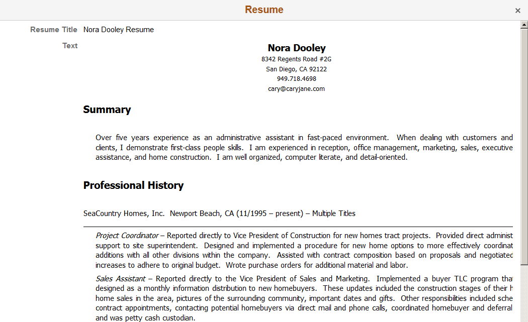

Applicants use the Resume page (HRS_APP_CE_RES_SCF) to view a resume that was pasted into the system.
Navigation:
In the Resumes grid on the My Job Applications page, click the Pasted Resume link that appears for resumes that were pasted into the system.
This example illustrates the Resume page.
This is a read-only page. Close the modal window to return to the My Job Applications page.

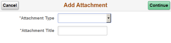

Applicants use the Add Attachment or Edit Attachment page (HRS_APPL_ATCH_SCF) to enter attachment information and upload attachments. Applicants additionally use the Edit Attachment page to delete attachments.
Navigation:
Click the Add button above the My Cover Letters and Attachments grid on the My Job Applications page.
Click the Edit button for an existing attachment in the My Cover Letters and Attachments grid on the My Job Applications page. The Edit button is present only for attachments that are not associated with a specific application.
This example illustrates the Add Attachment page.
This example illustrates the Edit Attachment page.

Add Attachment Fields
Field or Control |
Description |
Continue |
After supplying all required information, applicants click this button to open a generic File Attachment dialog box. The options for selecting files depend on the device and on any available integrations to cloud storage. |
Save |
After uploading an attachment using the File Attachment dialog box, the Save button replaces the Continue button. Clicking the Save button closes the page and adds the attachment to the My Cover Letters and Attachments grid on the My Job Applications page. |
Attachment Type |
Applicants must select an attachment type before uploading an attachment. The available values are the attachment types where the Attachment Type Setup Page has a Max Occurrences Outside of Applications value of one or more. The system does not check whether the applicant has already reached the specified maximum for the attachment type until the applicant clicks the Continue button. At that point, an error appears if the maximum has been reached. |
Attachment Title |
Applicants enter a descriptive title for the attachment. |
