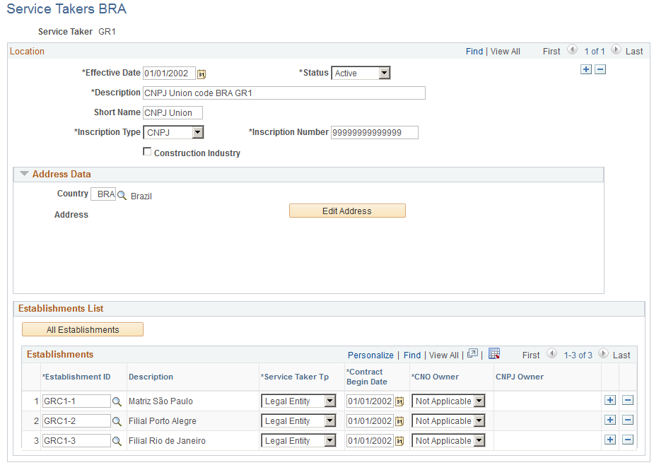

This example illustrates the fields and controls on the Service Takers BRA page.
Location
Field or Control |
Description |
Inscription Type |
Select the type of ID that identifies the service taker. Values are CEI and CNPJ. |
Inscription Number |
Enter the ID that identifies the service taker. |
Establishments List
Field or Control |
Description |
All Establishments |
Click this button to add all of the valid establishments for a service taker. The Establishments region enables you to define the relationship between service takers and establishments. |
Establishments
Field or Control |
Description |
Service Taker Tp (service taker type) |
Select the type of service contracted by the establishment, which is legal entity, according to eSocial requirements. |
Contract Begin Date |
Enter the date when the contract between the establishment and the service taker began. By default, the system populates this field with the service taker’s effective date (currently displayed on the page), or the earliest effective date of the establishment, whichever is the latest. This information is used in eSocial reporting. |
CNO Owner |
Select the CNO or CEI responsible. Values are: Estab (establishment) Not Applicable Other Service Taker If Other is selected, the CNPJ Owner field becomes available for edits. Note: This field is required only if the service taker is related a construction establishment with partial contract. |
CNPJ Owner |
Enter the CNPJ register number of the CEI responsible. This value is required if Other is selected in the CNO Owner field. |
