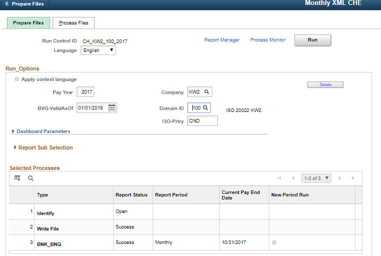

Use the Prepare Files CHE page (GPCH_EG_RSATUS) to prepare the ISO 20022 XML.
Navigation:
This example illustrates the fields and controls on the Prepare Files page.
Field or Control  |
Description  |
Domain ID  |
 For Monthly Processing, this will prompt only for monthly domains.  |
Report Period  |
 For Monthly Processing, this is always monthly.  |
Current Pay End Date  |
 Defaults to the earliest open End date in the selected year. You can only save, if payment pre CHE ran for this period.  |
Run  |
 Starts Job GPCH_AE_XML which launches for monthly menu Job GPCH_MONTH.  |
ISO-Prty  |
 The values fills TAG TP/PRTY. If empty TAG doesn’t get created.  |

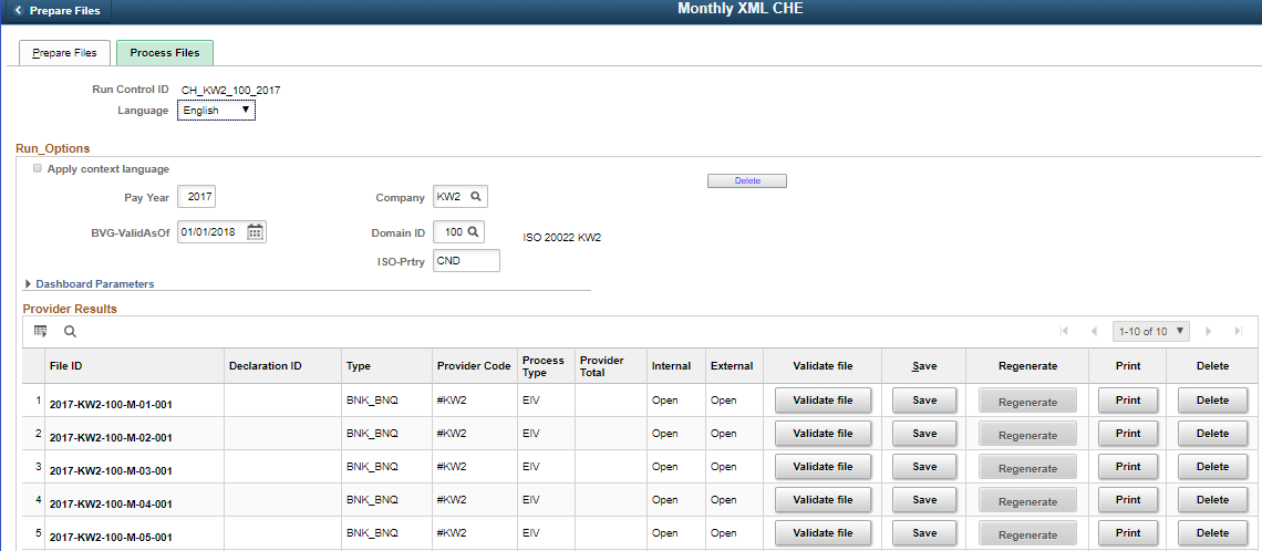

Use the Process Files CHE page (GPCH_EG_FSATUS) validate, review and save the ISO 20022 XML.
Navigation:
This example illustrates the fields and controls on the Process Files page.
Field or Control  |
Description  |
Validate  |
 Validates the XML vs. most recent ISO 20022 schema (currently pain.001.001.03.ch.02.xsd).  |
Save  |
 Saves the file to your target directory other than for all other domains save navigates directly to the robust file management page.  |
 Print contents of XML via BI Publisher.  |
Delete  |
 Delete the row for this month.  |

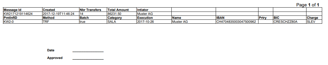

Reporting
A BI PUBLISHER report (GPCH_ISO20022) is delivered to print payment information. The data source of this report is the ISO 20022 XML.
BI Publisher ViewGen Parameters
This example illustrates the fields and controls on the BI PUBLISHER report (GPCH_ISO20022) for mode Summar ( = used for approval = 1 page) .
