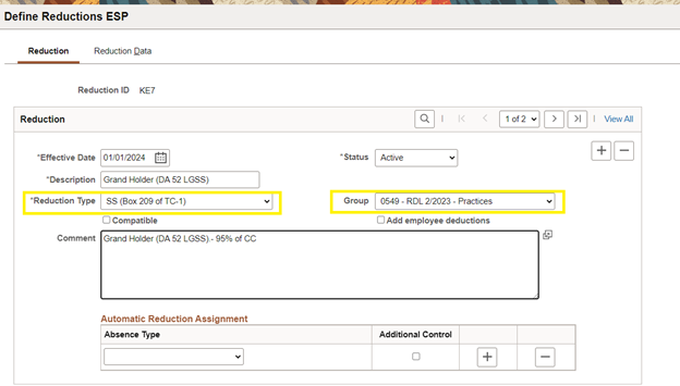

Companies can benefit from a Social Security reduction of 95% of Common contingencies contributions. Companies should create the specific reduction id, by selecting:
Reduction type: SS (Box 209 of TC-1)
Group: 0549- RDL 2/2023 -Practices
This example illustrates the fields and controls on the Define Reductions ESP page.

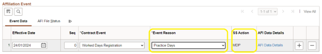

Effective January 2024, employers are required to report on a monthly basis the number of internship days completed by scholarship holders (without fellowship), who do not receive any compensation. To do so, the system provides two Social Security Actions - Action MDP: Practice Days Communication and Action EDP: Erase Practice Days.
This action is available under Work Days Registration Contract Event.
This example illustrates the Affiliation Event page.
Click AFI Data Details. This displays the AFI Data Details modal.

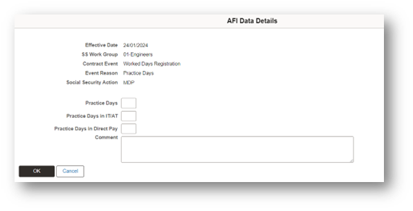

Field |
Description |
Practice Days |
Enter the number of practice days in the month. Position in DJD Segment: 57 |
Practice Days in IT/AT |
Enter the number of theoretical practice days during a period in temporary disability within the month. Position in DJD Segment: 59 |
Practice Days in Direct Pay |
Enter the number of theoretical practice days during an absence period of direct payment within the month. Position in DJD Segment: 61 |
The system verifies that the sum of the days entered in these three fields does not exceed the number of days in the month.
If all of these values are zero, the system will print a value of N in position 63 of the DJD segment.
