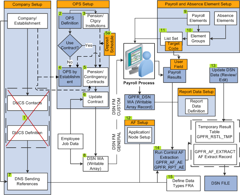

As the monthly DSN report generation follows the monthly payroll process, all the payroll related set ups such as OPS set ups, payroll & absence element setups etc. are prerequisites for DSN data extraction.
To set up DSN extraction, use Define Data Types FRA and DSN Sending Reference FRA components.
This diagram shows how the data is extracted in DSN Reporting process.
  Note: From DSN 3.3 version onwards the DUCS Contacts and DUCS Definition components are not used for DSN.

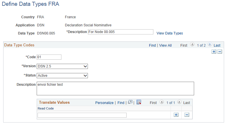

Use the Define Data Types FRA page (GPFR_DT_VALUES) to define and view data types with list of codes for specific attributes based on DSN technical book and its translate values. For a specific data type you can define multiple data type codes.
Navigation:
This example illustrates the fields and controls on the DSN Data Types FRA page. You can find definitions for the fields and controls later on this page.
   Click the View Data Types link to view the list of codes and versions defined against the selected data type.
         Field or Control  |
         Description  |
         Code  |
         Enter a DSN code. These are the codes defined in the DSN technical book for specific attributes.  |
         Version  |
         Select the application version to be used. This version corresponds to the technical book version released by the French Government. Based on the version selected here, the extraction process identifies the data type codes to be considered for reporting.  |
         Read Code  |
         Maps the field value to the DSN code specified in the associated Code field. The field value is extracted from the PeopleSoft application.  |

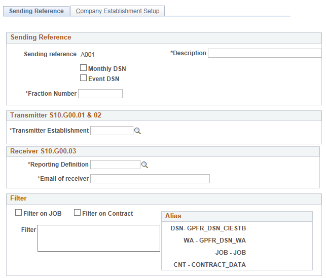

Use the Sending Reference page (GPFR_DSN_SNDREF) to create a sending reference that defines the transmitter and receiver of the DSN file. It is also used to identify the establishments to be included in the DSN declaration

   Sending Reference
          Field or Control  |
          Description  |
          Monthly DSN  |
          Select the checkbox if the DSN file needs to be sent monthly.  |
          Event DSN  |
          Select the checkbox if the DSN file needs to be sent on occurrence of an event.  |
          Fraction Number  |
          Enter a fraction number. This is to identify the fraction of the DSN file if there are multiple files generated by multiple systems. This information is fed into the attribute S20.G00.05.003  |
Transmitter
          Field or Control  |
          Description  |
          Transmitter Establishment  |
          Select an establishment defined in the PeopleSoft HR Establishment table. The transmitter establishment is the establishment corresponding to the selected company that sends the DSN information.  |
Receiver
          Field or Control  |
          Description  |
          Reporting Definition  |
          Select an entry defined on the Reporting Establishment page. It is the establishment to which the DSN information is reported. For each company, a Reporting Establishment must be indicated.  |
          Email of receiver  |
          Enter the email id of the receiver.  |

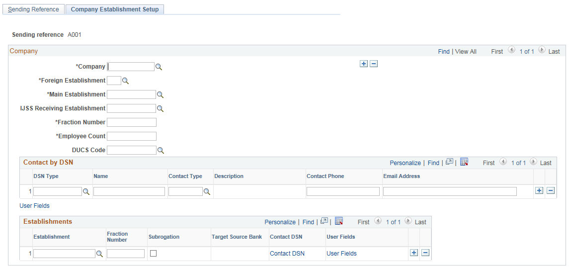

Use the Company Establishment Setup page (GPFR_DSN_SNDREF1) to select the companies / establishments to be grouped for the DSN output file.
Multiple companies/establishments can be selected and grouped under a single sending reference.
This example illustrates the fields and controls on the Company Establishment Setup page. You can find definitions for the fields and controls later on this page
   Navigation:
Company
You can define multiple companies and corresponding parameters under a single sending reference.
          Field or Control  |
          Description  |
          Company  |
          Select the company that generates DSN file for the defined sending reference.  |
          Foreign Establishment  |
          To identify if the company is:
          Main Establishment  |
          Select the main establishment that handles the regulatory requirements of the selected company.  |
          IJSS Receiving Establishment  |
          Select the establishment that handles the IJSS related information of the selected company.  |
          Fraction Number  |
          Enter a fraction number. This is to identify the fraction of the DSN file if there are multiple files generated by multiple systems. This information is fed into the attribute S20.G00.05.003. Note that this precedes the one defined under Sending Reference level.  |
          Employee Count  |
          Enter the number of employees included in the DSN process from the selected company.  |
          DUCS Code  |
          Select the DUCS code associated with the company. These are defined under DUCS Definition FRA component, which is used only for DSN version 2.5 and not used thereafter.  |
Contact by DSN
For each company selected, you can enter the contact information based on the DSN file type. You can add multiple DSN types and corresponding contact details for the selected company.
          Field or Control  |
          Description  |
          DSN Type  |
          Select the type of DSN file based on the information to be reported.  |
          Contact Type  |
          Select the type of the contact to be used based on the information to be reported.  |
Establishment
For the selected company, you can add multiple establishments and corresponding contact details. Note that only these establishments will be considered for DSN Reporting.
          Field or Control  |
          Description  |
          Establishment  |
          Select the establishment corresponding to the selected company.  |
          Subrogation  |
          Select the checkbox if subrogation facility needs to be enabled.  |
          Contact DSN  |
          The Contact Information Defined here precedes the Contact Information provided at Company level.  |
