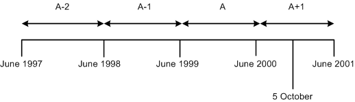

Accumulation Periods for Paid Vacation (CPE CG PAYES)
Period |
Period Name |
Comments |
Current reference period |
A+1 |
Current period of accumulation. |
Current period (for taking vacation). |
A |
Entitlement calculated in A+1 is transferred to A each 31 May or 1 June. |
The period before the previous period. |
A-1 |
The balance for the current period is transferred to A-1 each 31 May or 1 June. |
The period before A-1. |
A-2 |
The balance for A-1 is transferred to A-2 each 31 May or 1 June. |
Example: Assume today is 5 October 2000. If the reference period is 1 June to 31 May, then the relevant accumulation periods appear in the following diagram:
Global Payroll for France tracks four totals for each accumulation period: entitlement earned, entitlement balance, take, and adjustments. For each, the accumulation period is set to Year To Date. By default, the Begin Option date is 1 June, meaning that the accumulation period runs from 1 June to 31 May of the following year.
Change the beginning month of the reference period by updating the variable CPA VR MOIS DEB REF. The Begin Option field refers to CPA VR MOIS DEB REF for the month. So, if the variable is set to 1, the accumulation period begins in January; if it is set to 5, the period begins in May, and so on.
Note: If you change the reference year by updating the variable element CPA VR MOIS DEB REF, the system automatically updates the accumulator periods for CPE CG PAYES.
Paid Vacation In-Lieu Allowance: Upon leaving a company, a payee is entitled to compensation in-lieu of any unused paid vacation days. Global Payroll for France automatically calculates the correct earnings for terminated payees, generating earnings for each day of unused paid vacation, seniority paid vacation, split vacation days, and other paid vacation days for which the employee is entitled to receive compensation.
Generation control triggers the calculation of allowances for paid vacation in-lieu. The system can generate up to four earnings for each period of paid vacation (if any days remain in the previous periods): A-2, A-1, A, and A+1. (The four accumulation periods are described in the previous topic.)
The system does not pay entitlement earned during the current reference period (A+1) when you select Termination in the Action/Reason field in Job Data, and then select misconduct (CON) or gross misconduct (GMI).
