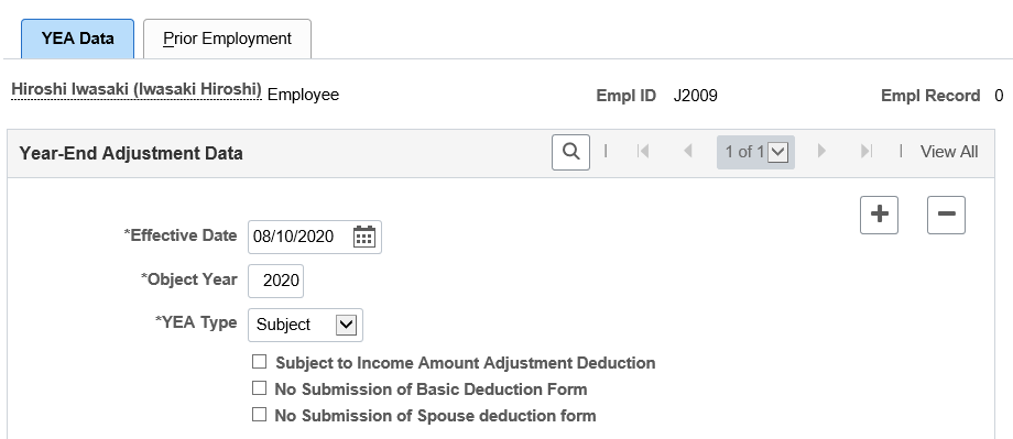

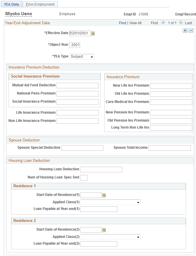

Use the YEA Data (year-end data) page (GPJP_YEA_PYEADJ) to enter deduction data (housing acquisition deduction, insurance, and spouse deduction) and edit YEA type.
Navigation:
This example illustrates the fields and controls on the YEA Data page with Object Year below 2020. You can find definitions for the fields and controls later on this page.
This example illustrates the fields and controls on the YEA Data page with Object Year 2020 and above. You can find definitions for the fields and controls later on this page.
Field or Control |
Description |
YEA Type (year end adjustment type) |
Select a value to indicate whether the employee is subject to income amount adjustment deduction. The default is Subject. Select Not Subject to exclude the employee from the YEA process. |
If user declaration is done outside the system and not though the Self-Service option, you have the flexibility to enter YEA data declaration directly in Maintain Year End Adj JPN page.
If you enter Object Year as ‘2020’ or above, the following checkboxes are displayed.

Subject to Income Amount Adjustment Deduction |
Select the checkbox to enable income amount adjustment deduction for an employee. This checkbox is enabled only for employees falling in either of the following categories:
The administrator needs to select the “Subject to Income Amount Adjustment Deduction” check box in “Maintain Income Tax Data JPN” page or “Maintain Dependent Dep Tax Data JPN” page for the above mentioned categories. If the user selects the check box in the “Maintain Year End Adj Data JPN” page without selecting the check box in the respective page then, the application displays error message as “Neither Employee nor Dependent has Subject to Income Amount Adjustment Deduction selected”. |
No Submission of Basic Deduction Form |
Select the check box if the employee has not submitted Basic Deduction Form. If this check box is selected, then the employee will not get Personal Basic Exemption. |
No Submission of Spouse Deduction Form |
Select the check box if the employee has not submitted Spouse Deduction Form. If this check box is selected, then the spouse deduction amount will be considered as zero. |

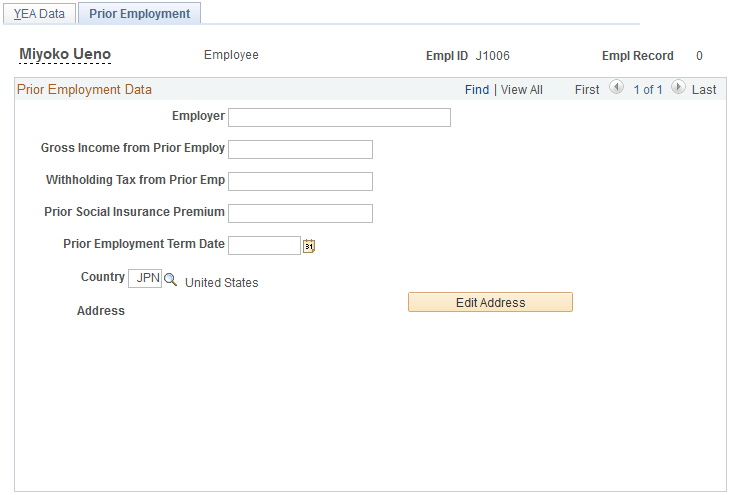

Use the Prior Employment page (GPJP_YEA_PYEPRI) to enter prior employment data, such as income, tax, social insurance premium, and the prior employer's name and address.
Navigation:
This example illustrates the fields and controls on the Prior Employment page.
