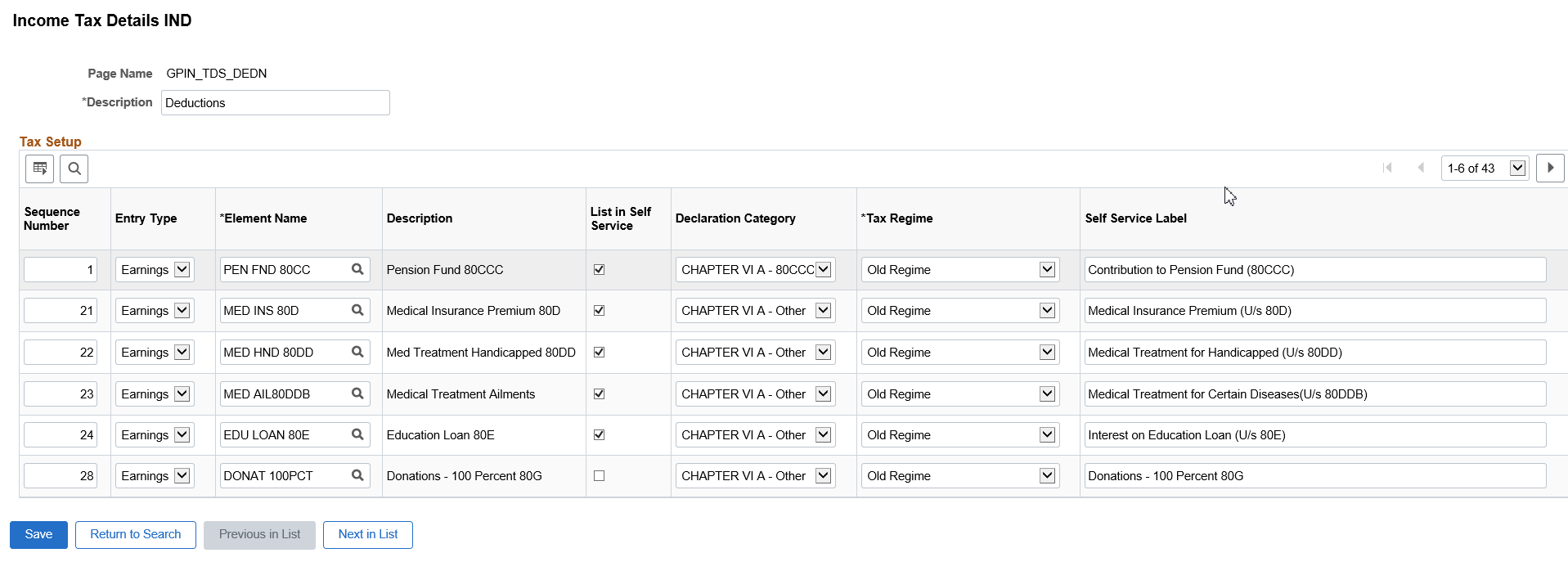

Use the Tax Setup – Deductions page (GPIN_TDS_DEDN) to set up information for deductions Under Chapter VI A.
Navigation:
This example illustrates the fields and controls on the Tax Setup – Deductions page. You can find definitions for the fields and controls later on this page.
Note: See field descriptions under the Common Elements heading at the beginning of this section.

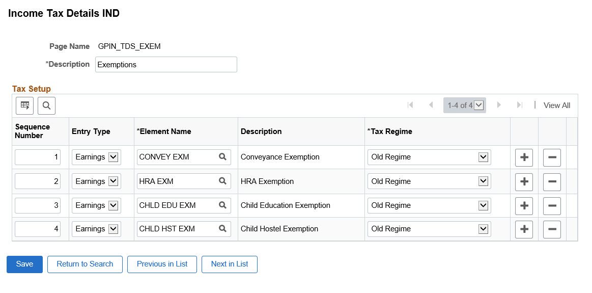

Use the Tax Setup – Exemptions page (GPIN_TDS_EXEM) to set up tax exemptions.
Navigation:
This example illustrates the fields and controls on the Tax Setup – Exemptions page. You can find definitions for the fields and controls later on this page.

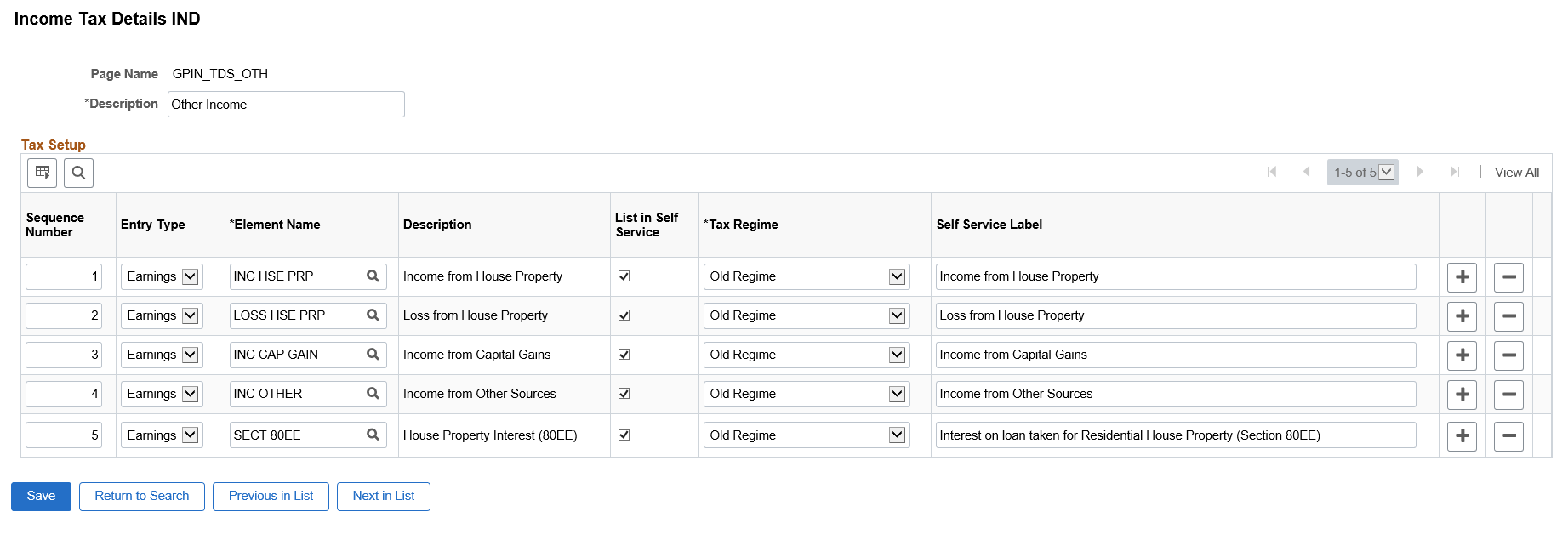

Use the Tax Setup – Other Income page (GPIN_TDS_OTH) to set up other income information.
In addition you can enable self service functionality using this page.
Navigation:
This example illustrates the fields and controls on the Tax Setup – Other Income page. You can find definitions for the fields and controls later on this page.

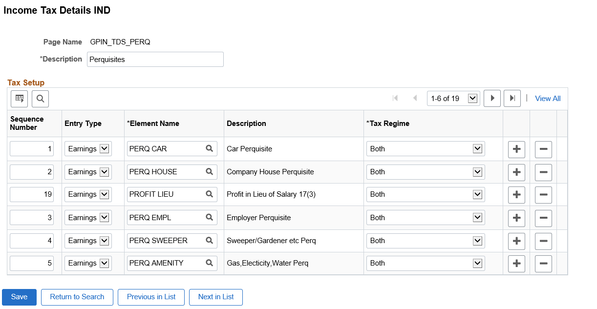

Use the Tax Setup – Perquisites page (GPIN_TDS_PERQ) to set up information for perquisites.
Navigation:
This example illustrates the fields and controls on the Tax Setup – Perquisites page. You can find definitions for the fields and controls later on this page.
