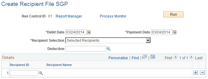

Use the Create Recipient File SGP page (GPSG_RUNCTL_RCP_FL) to enter the parameters for generating recipient payment files.

This example illustrates the fields and controls on the Create Recipient File SGP page.
Field or Control |
Description |
Debit Date |
The system extracts recipient payments where the debit date is equal to the recipients deposit schedule. If the recipient does not have a deposit schedule the system extracts payments using the debit date without reference to a deposit schedule. |
Payment Date |
This the date, passed to the file header, that the bank passed the payment to the recipient. |
Recipient Selection and Deduction |
Select from: All Recipients, Selected Deduction, or Selected Recipients. You select only one deduction but multiple recipients for the second and third options. |
