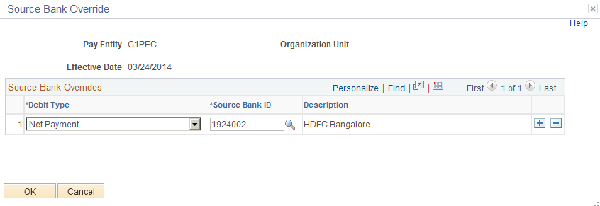

Use the Source Bank Override page (GPSG_PE_SBANK_SEC) to link source banks to debit types for a particular organizational unit.
The read-only detail displayed on this page comes from your setup on the core Global Payroll Source Bank Link page of the Pay Entity component.
Navigation:
Click the Source Bank Override link on the Pay Entity Source Bank SGP page.
This example illustrates the fields and controls on the Source Bank Override page.
Field or Control |
Description |
Debit Type |
Enter a Debit Type of Net Paymt (payment) or Recipient. |
Source Bank ID |
Enter the ID of the source bank you want to use to pay the debit type. |
