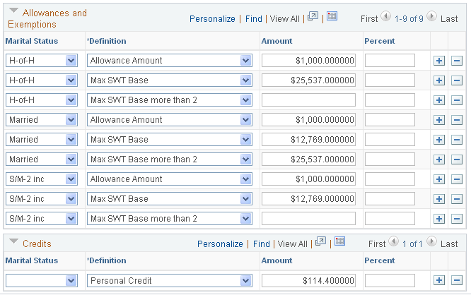

Standard Deductions
This group box contains the state-specific standard deductions that the system references when calculating state income tax.
Allowances and Exemptions
This group box contains the state-specific allowances, exemptions, and maximum SWT base and limits that the system references when calculating state income tax.
Credits
This group box contains the state-specific credits that the system references when calculating state income tax.

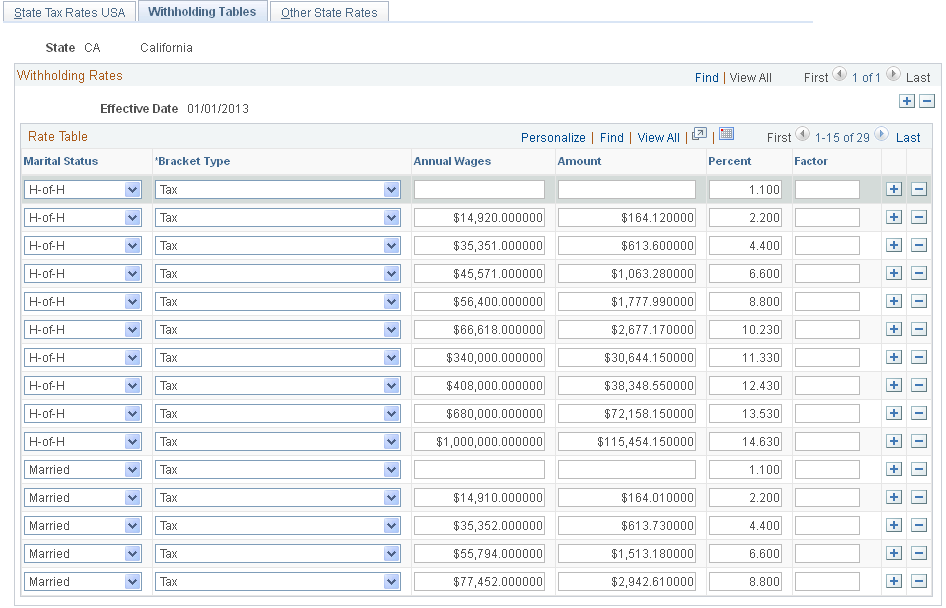

Use the Withholding Tables page (GPUS_TAX_ST_TBL) to define withholding rates.
Navigation:
This example illustrates the fields and controls on the Withholding Tables page.
This page lists all of the state-specific wage brackets and withholding rates referenced by the SWT calculation process.

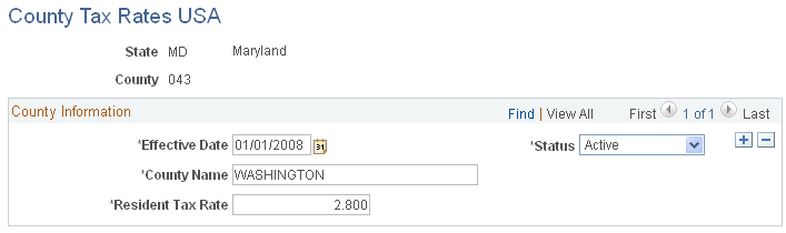

Use the County Tax Rates USA page (GPUS_LOCAL_TAX) to maintain county tax rates.
Navigation:
This example illustrates the fields and controls on the County Tax Rates USA page.
Use this page to maintain the resident tax rate for a county within a given state.
