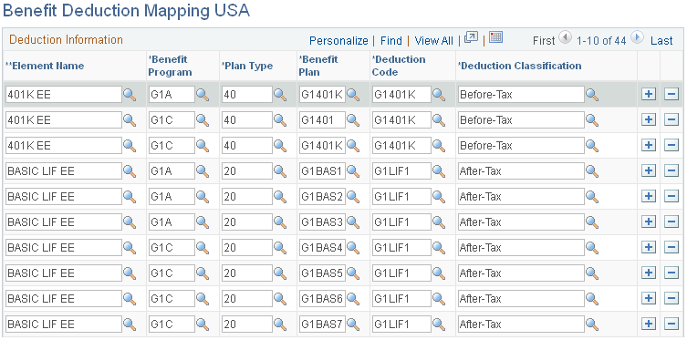

Use the Benefit Deduction Mapping USA page (GPUS_BENDED_MAP) to link deduction codes created in Payroll for North America to deduction elements created in PeopleSoft Global Payroll for United States.
Navigation:
This example illustrates the fields and controls on the Benefit Deduction Mapping USA page.

Element Name  |
 Select a benefit deduction element. Element names available for selection have a country code of USA, a PIN_TYPE of DD, and a PIN_CATEGORY of BEN.  |
Benefit Program  |
 Select a benefit program. Available benefit programs are pulled from the benefit programs defined by the PeopleSoft HR Manage Base Benefit business process.  |
Plan Type  |
 Select a plan type. Available plan types are pulled from the plan types defined by the Manage Base Benefit business process.  |
Benefit Plan  |
 Select a benefit plan. Available benefit plans are pulled from the benefit plans defined by the Manage Base Benefit business process.  |
Deduction Code  |
 Select a deduction code. Available deduction codes are pulled from the deduction codes defined by Payroll for North America.  |
Deduction Class  |
 Select a deduction class.  |
Warning! After mapping the deduction elements to the deduction codes, do not delete any entries.
