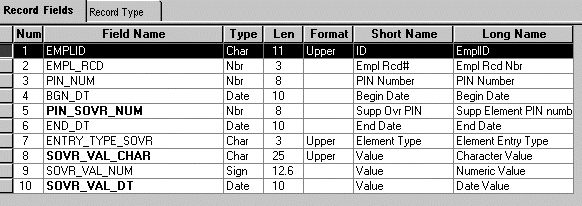

Use PeopleTools to create a SQL view for the record.
The view must have the same structure as your new record, as illustrated in the following example.
In the Select statement, enter + 50 000 000 after each field in the record that references a PIN number.

Example
This illustration shows how your SQL statement should match the record structure.
SELECT EMPLID
,EMPL_RCD
,PIN_NUM + 50000000
,BGN_DT
,PIN_SOVR_NUM + 50000000
,END_DT
,ENTRY_TYPE_SOVR
,SOVR_VAL_CHAR
,SOVR_VAL_NUM
,SOVR_VAL_DT
  FROM PS_GP_PYE_OVR_SOVR
