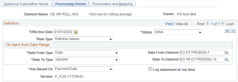

Use the Historical Rules - Processing Period page (GP_HIST_RULE1) to define the details of the processing period for the historical rule.
Depending on what you select as the rule type, some fields may not be available for entry.
Navigation:
This example illustrates the fields and controls on the Historical Rules - Processing Period page.
Note: On the Processing Period page, you create the periods from the date from to the date to date. You then map the selected result data to the processing periods. If no data exists for an element in a period, it is set to spaces for character and date elements and to zeros for numeric and monetary elements.
Field or Control |
Description |
Rule Type |
Select the type of historical rule from these options: Use in Fictitious Calculation: Select when you want to use a historical rule element in a fictitious calculation element to determine which pay periods to recalculate. Retrieve Values: Select when you want to use a historical rule element in a formula to retrieve previously calculated values. |
Go back from Date Range |
Define the date from, date to type, date from element, and date to element to establish the rule's date range. If you select a Retrieve Values rule type, this field appears as Go Back From Date Range. If you select a Use in Fictitious Calculation rule type, this field appears as Go Forward From Date Range. Select from the following values in the Date From Type and Date To Type fields: Bracket Cal Date (calendar date): Enter a date instead of an element that resolves to a date. In the next field, specify the date to start going back from (for historical rules) or to start going forward from (for fictitious rules). Date Formula SystemElem (system element) Variable |
Use Based On |
Select a date that tells the system which data values from the GP_RSLT tables are processed by a historical rule. Select from these values: Period End Date, Period Begin Date or Payment Date. |
Log statement at run time |
Select this check box to see the text of the SQL statement dynamically generated by the array module during batch processing. You can direct the output display into a file by selecting the Redirect Output option in PeopleTools Configuration Manager. |
Example

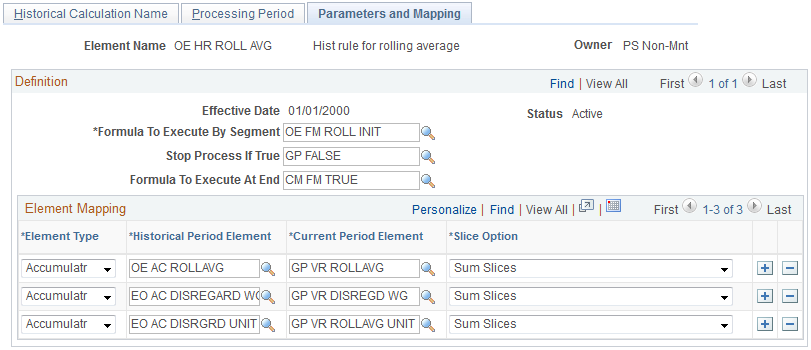

Use the Parameters and Mapping page (GP_HIST_RULE2) to define the formula for a historical rule.
Navigation:
This example illustrates the fields and controls on the Parameters and Mapping page.
Note: Depending on whether you specified a historical or fictitious rule type on the Processing Period page, different fields appear on this page.
When you run a payroll, the system resolves the Formula to Execute by Segment field per historical period until the Stop Process If True variable is not equal to zero or the last historical period is processed. The system then resolves the formula specified in the Formula To Execute at End field.
Field or Control |
Description |
Formula to Execute By Segment |
Enter the formula to be resolved for each segment or period. |
Stop Process If True |
Enter a variable. The process keeps looping through periods, resolving the formula for each period, until this variable doesn't equal zero, the date to date is reached, or no more data is found. |
Formula To Execute At End |
Select the formula to resolve when period processing is completed. |
Use Period If True |
This field appears for Use in Fictitious Calculation rule types only. Enter a variable. After each call to the Formula to Execute By Segment field, this variable is checked for zero or one. If it's set to one, the fictitious calculation process uses the period for which the formula was called. |
Element Mapping
The grid in the Element Mapping group box lists the elements for retrieval from the Global Payroll result tables for a historical rule.
Field or Control |
Description |
Element Type |
Select the type of element—such as the earning, deduction, or variable—to retrieve. |
Historical Period Element |
Enter the element that you want to retrieve. |
Current Period Element |
Enter the variable in which the retrieved value is to be stored. This variable becomes available for use in the Formula to Execute By Segment field. |
Slice Option |
Specify how the system resolves multiple instances of an element in the historical period. Values are:
