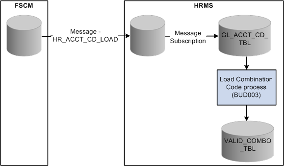

Importing from the Financials Database
If you integrate with PeopleSoft Financials 8.0 or later, you can import the valid ChartField Combinations from the Financials database and keep them up to date using Integration Broker.
To import valid combinations from Financials:
Publish combination data information from Financials (FSCM) to HCM using the HR_ACCT_CD_LOAD Integration Broker service operation.
When HCM receives this service operation, the handler arranges the data in the correct layout and populates the GL_ACCT_CD_TBL.
Run the Load Combination Code SQR process (BUD003) to populate the Valid Combination table.
This diagram illustrates importing valid combination codes from the Financials database as described above:

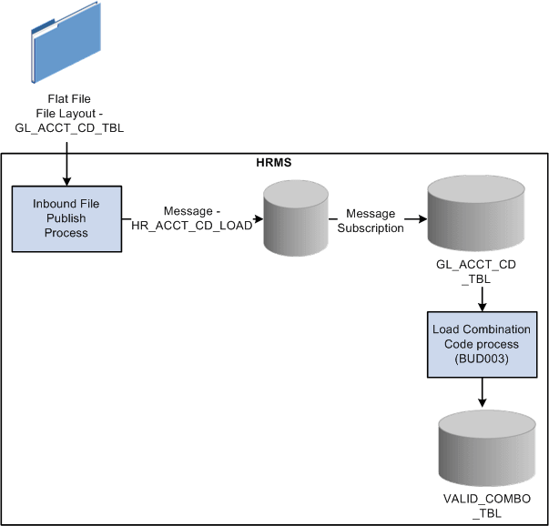

Flat File Loading
If you integrate with a financials system that does not have Integration Broker capability, you can use the Inbound Flat File process to load and maintain the Valid Combination table (VALID_COMBO_TBL).
To populate valid combination codes using the Inbound Flat File process:
Create a flat file that contains valid combination data in the layout format specified by GL_ACCT_CD_TBL.
Initiate the Inbound Flat File process to publish this combination data using the HR_ACCT_CD_LOAD service operation.
When the service operation is received, the handler arranges the data in the correct layout and populates the GL_ACCT_CD_TBL
This diagram illustrates importing valid combination codes using a flat file as discussed above:

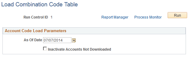

Use the Load Combination Code Table page (RUNCTL_FILEPATH) to run the Load Combination Code process (BUD003) to load the Combination Code table with ChartField combinations already imported into the GL_ACCT_CD_TBL using the HR_ACCT_CD_LOAD service operation.
Navigation:
This example illustrates the fields and controls on the Load Combination Code Table page. You can find definitions for the fields and controls later on this page.
Field or Control  |
Description  |
As of Date  |
 Enter the as of date for the ChartField combinations you are importing from PeopleSoft General Ledger.  |
Inactivate Accounts Not Downloaded?  |
 When this option is selected, the system inactivates combinations for which it doesn't find matches in the current fiscal year. When this option is blank, old combinations remain active for the current fiscal year.  |

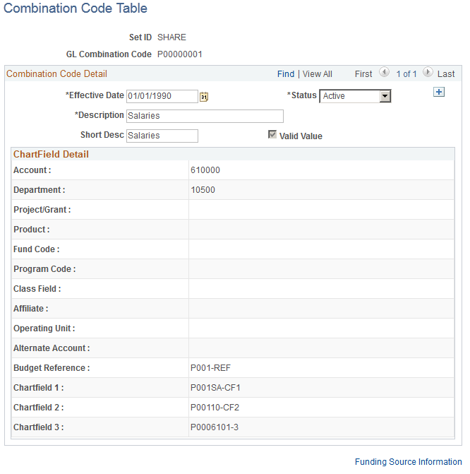

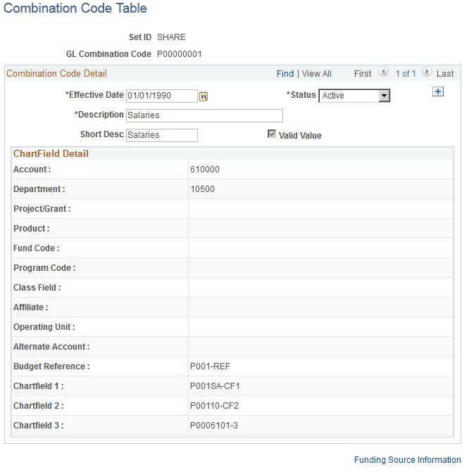

Use the Combination Code Table page (VALID_COMBO_TBL) to review all combination codes imported into HCM and loaded by the Load Combination Code process (BUD003) Manually define and review valid combinations of ChartField values if not importing them.
Navigation:
This example illustrates the fields and controls on the Combination Code Table page. You can find definitions for the fields and controls later on this page.
Note: You cannot change the ChartField values for combination codes imported from Financials, but you can change the description and make it active or inactive.

GL Combination Code (general ledger combination code)  |
 Enter this code on the HCM pages to use this combination of ChartFields in a transaction. The system generates the combination code sequentially based on the Installation table's Last Combination Code Assigned field under these conditions:
Valid Value  |
 This field is available for entry when entering the ChartField combination for the first time for the setID. Select it if the ChartField combination is valid. If the combination already exists with the same setID, this field is populated based on the value of the preexisting combination and is unavailable for change.  |
Funding Source Information  |
 Click this link to view the Funding Source Information page, which displays the default funding end date. The Manage Commitment Accounting business process uses the default funding end date in department budgets and in encumbrance definitions.  |
ChartField Detail
If you're setting up combination codes manually, enter the ChartField value for each ChartField that applies to this ChartField combination.
Note: Only the ChartFields that are active on the Standard ChartField Configuration page are visible on this page.
