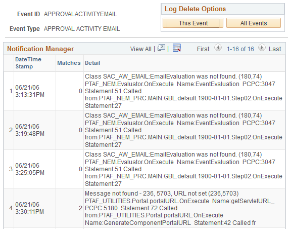

Use the Event Status page (EOAW_NEM_STATUS) to view the status of an event.
Navigation:
This example illustrates the fields and controls on the Event Status page. You can find definitions for the fields and controls later on this page.
Log Delete Options
Field or Control |
Description |
This Event |
Click to delete all notification event logs for the event ID that you selected. |
All Events |
Click to delete all notification event logs for all events. |
Notification Manager
Field or Control |
Description |
DateTime Stamp |
Used in the Status record to track the results of each instance run. |
Matches |
Displays the number of rows that are returned from a row set. |
Detail |
Displays detailed status messages for each notification event. |
