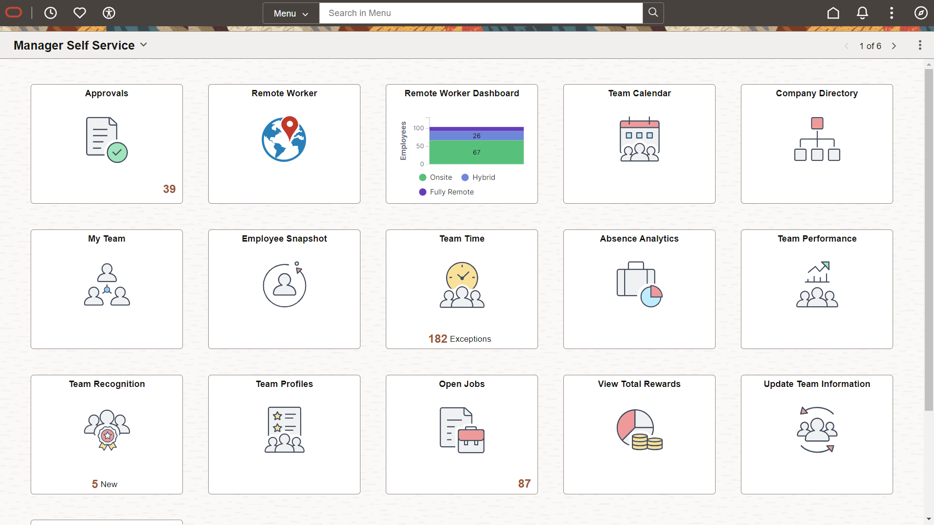

Use the Manager Self Service homepage to access a variety of manager self-service transactions. The cref for this page is HC_HR_MGR_SELF_SERVICE_FLU_GBL.
Navigation:
When you first sign in, the default homepage title appears at the top of the homepage. If the Manager Self Service homepage is not your default homepage, tap the title of the default homepage and select Manager Self Service from the list that appears.
This example illustrates the Manager Self Service homepage.

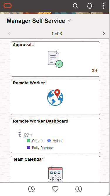

This example illustrates the Manager Self Service homepage for the smartphone. Action buttons, which appear on the page banner when viewed with a laptop or tablet, are available in the actions list when viewed with a smartphone.
PeopleSoft HCM Tiles on the Manager Self Service Homepage
The following table describes the tiles on the delivered Manager Self Service homepage. The table also identifies navigation paths to equivalent classic pages. These are the menu paths that are replaced by fluid navigation paths due to Fluid Transactions and Conditional Navigation when the user is in fluid mode.
Tiles are listed in alphabetical order. On the homepage, users can personalize the tile order.
