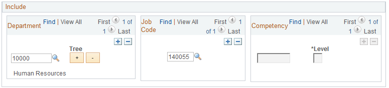

Include
Field or Control |
Description |
Department, Job Code, and Competency |
Select the department, job code, and competency to include in the scenario. To include both the department and its child departments in the department tree, use one of the buttons below the tree. |
Click the Expand button to add related departments in the department tree to the list on this page. Then you can add several departments to the list in one step. |
Click the Collapse button to delete related departments from the list. The system deletes only the departments that you added by clicking the Expand button. Departments that you added manually remain in the list, even if they are related departments. |

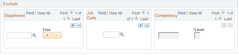

Exclude
Field or Control |
Description |
Select the department, job code, and competency to exclude from the scenario. Use the Expand and Collapse buttons to add or remove departments from the department tree. Note: You can select only departments that are associated with the business unit that you associated with the new global scenario in the Business Unit field. |
Criteria Statement Example
In the following example, the selection includes employees in department 10000 who are assigned to job code 140055, Payroll Analyst:
In the same selection criteria statement, you can exclude employees with an expert rating (level 5) in competency 0703, Negotiation, as shown in this example:
Note: You can decide not to enter a department, job code, or competency in a criteria statement. For example, if you specify department 1000 and competency 0703, but leave the job code field blank in the Exclude criteria statement, the system excludes any employee in department 10000 with an expert rating in competency 0703.

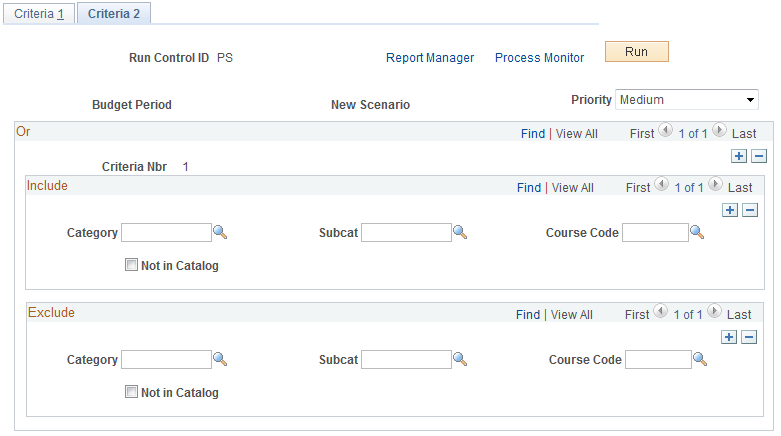

Use the Training Scenario by Criteria - Criteria 2 page (RUNCTL_TRN008_2) to write criteria to specify courses to include in the scenario.
Navigation:
This example illustrates the fields and controls on the Training Scenario by Criteria - Criteria 2 page. You can find definitions for the fields and controls later on this page.
For each demand selection statement (criteria number) that you defined on the Training Scenario by Criteria - Criteria 1 page, enter the courses to include or exclude from the global scenario.
Field or Control |
Description |
Category, Subcat, (subcategory), and Course Code |
In the Course Code fields, select a course that is associated with the selected category and subcategory. |
To calculate costs for the courses that are not in the catalog, the costs for the course (such as vendor, instructor, and facility costs) need to be stored in the Course Cost table.
For example, if you include the category Computers, the subcategory OPER SYS (operating systems), and the course code 4002, DOS/Windows Operating System, the global scenario includes all the demands that you have for that course.

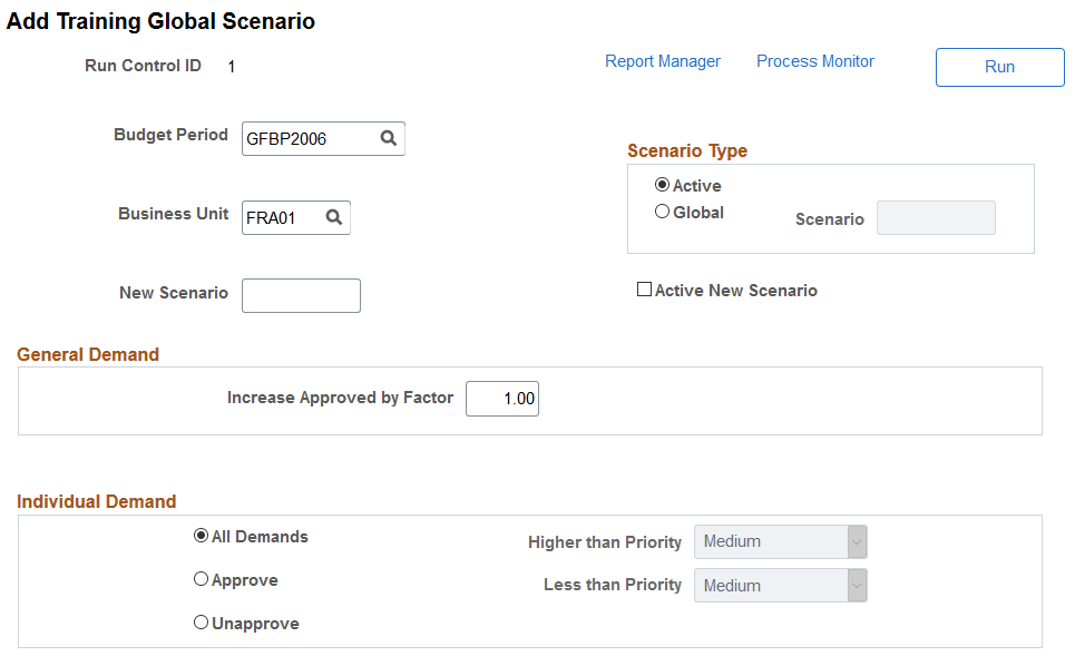

Use the Add Training Global Scenario page (RUNCTL_TRN007) to create a scenario by copying a global or active scenario that you previously created for another budget period or business unit.
Navigation:
This example illustrates the fields and controls on the Add Training Global Scenario page. You can find definitions for the fields and controls later on this page.

Budget Period and Business Unit |
Select the budget period and business unit to be associated with the new scenario. |
Scenario Type
Field or Control |
Description |
Active |
Selects the current active scenario for the specified business unit. You can have only one active scenario for a specified budget period. |
Global |
If you select global, select an existing global scenario as the source for the new scenario. |
Note: If the budget period that you specified is frozen, you cannot make the global scenario that you're defining here the active scenario.
General Demand
Field or Control |
Description |
Increase Approved by Factor |
Enter a multiplier:
For example, if you enter .75, and the source scenario specifies 100 approved demands, then the new global scenario will have 75 approved demands after the build process. To double the approved demands, enter 2. The result will be 200 approved demands in the new scenario. |
