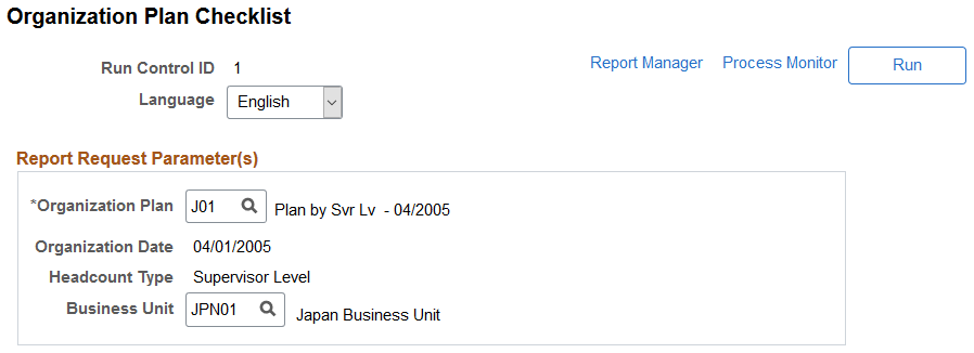

Use the Organization Plan Checklist page (RC_IDO_AUD1_JPN) to run the Employees in Inactive Department report PER069JP) to list employees who will be in inactive departments and run the Open Post Checklist report (PER070JP) to list the Open Post Checklist.
Navigation:
This example illustrates the fields and controls on the Organization Plan Checklist page. You can find definitions for the fields and controls later on this page.
Use this page to run the Employees in Inactive Department (PER069JP) report and the Open Post Checklist report (PER070JP).
The purpose of the Open Post Checklist report is to list cases where the actual head count in a department (after simulating the insert into the Job record) does not match the head count goals entered in the Headcount Plan by Department page. The Open Post checklist report only lists head count when the goal and actual numbers do not match.

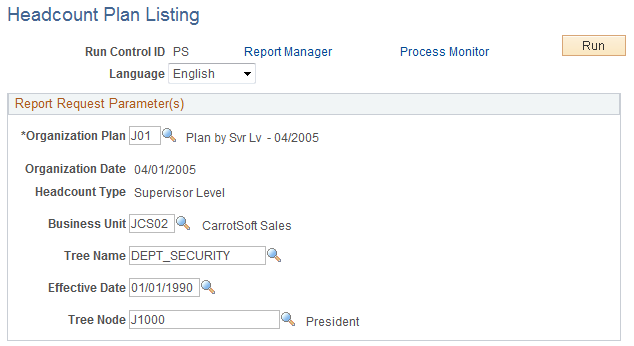

Use the Headcount Plan Listing page (RC_IDO_HC_RPT_JPN) to use this report to list the head count of the new organization structure.
Navigation:
This example illustrates the fields and controls on the Headcount Plan Listing page. You can find definitions for the fields and controls later on this page.
Use the Actual Headcount Report to list the actual headcount of an organization plan. This report is the same as the Open Post Checklist report except that it lists both matching and unmatching headcount numbers.

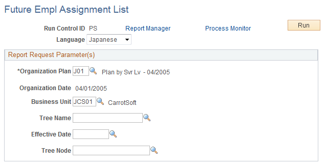

Use the Future Empl Assignment List page (RC_IDO_FUT_ASN_JPN) to use this report to simulate the way that the organization would look at an employee level if the selected organization plan is processed.
Navigation:
This example illustrates the fields and controls on the Future Empl Assignment List page. You can find definitions for the fields and controls later on this page.
Use this report to simulate the way that the organization would look at an employee level if the organization plan is processed.

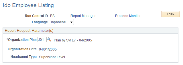

Use the Ido Employee Listing page (RC_IDO_AUD2_JPN) to this report summarizes the changes that will be made if the selected organization plan is processed.
Navigation:
This example illustrates the fields and controls on the Ido Employee Listing page. You can find definitions for the fields and controls later on this page.
This report summarizes the changes that will be made if the organization plan is processed. The report is in CSV format so that you can open the file as a spreadsheet.

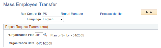

Use the Mass Employee Transfer page (RC_IDO_MASS_TR_JPN) to run this process to copy data from the Update Transfer Data table and insert it into the Job record.
Navigation:
This example illustrates the fields and controls on the Mass Employee Transfer page. You can find definitions for the fields and controls later on this page.
After you decide which organization plan to use, run the batch Mass Employee Transfer process. This process updates the database with the new the organization plan. It copies data from the Update Transfer Data table and inserts it into the Job record.
If multiple job rows exist with the same effective date, the same effective date is used, however the effective sequence is incremented. For example, if you want to insert a row into the Job table effective January 1, 2004, but a January 1, 2004 row already exists (with an effective sequence of 0), the process will insert the new row with an effective sequence of 1.

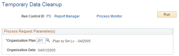

Use the Temporary Data Cleanup page (RC_IDO_CLEAN_JPN) to run this process to delete data associated with an organization plan.
Navigation:
This example illustrates the fields and controls on the Temporary Data Cleanup page. You can find definitions for the fields and controls later on this page.
Run this process after the Mass Employee Transfer process completes successfully. After the employees are reorganized and their data inserted into the Job record, there is no longer a need to keep the planning information in the database. For the organization plan selected, this process deletes rows from these tables:
IDO_FUT_UPD_JPN
IDO_TAMATSU_JPN
IDO_CANDIDT_JPN
IDO_HC_DEPT_JPN
