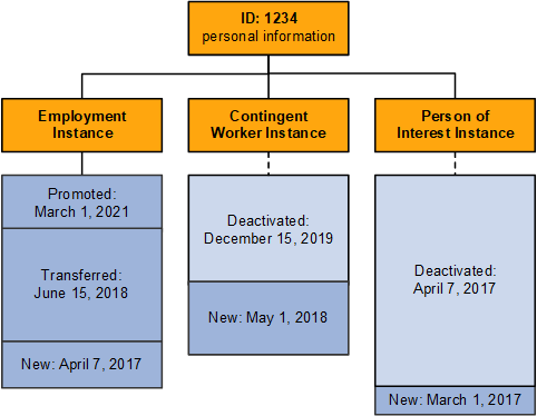

Example: A Person with Three Organizational Instances
Mario Estevez needs to successfully complete training with a third-party vendor before starting his new position. To reimburse Mario for the cost of the training, he needs a job record. The human resources administrator adds him in the system by using the Add a Person component and assigns him the ID 1234. The administrator then creates a POI job record for him by using the Add Person of Interest Job component.
After Mario completes his training, he joins the company as an employee. The human resources administrator terminates his POI instance (by using the Job Data component) and creates an employment instance by using the Add Employment Instance component.
A little more than a year after joining the company, Mario is given the opportunity to participate in a short-term project. The human resources administrator creates a contingent worker instance for him on the Add Contingent Worker Instance component.
Mario is later transferred and promoted in his employee job, and a new job data row is inserted for each of these changes. The historical job records accumulate under the organizational instance in which they are created. The human resources administrator updates the job records for the employment and contingent worker instances by using the Job Data component.
This table lists the changes to Mario's job records over a four-year period:

This diagram illustrates how the system stores Mario's data: under the person record, there are separate employee, contingent worker, and POI organizational instances, each with its own event history:

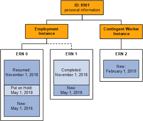

Example: A Person with Multiple ERNs
Jan Smith is hired to work in the sales division of Sutter Enterprises. After two years of outstanding performance, she starts a six-month temporary assignment in a subsidiary company to assist with the launch of a new application. At the end of the assignment she returns to her original job, but three months later she takes on a consulting role at the subsidiary in addition to her sales job. This table lists the changes to Jan's job records over the three-year period:

Contingent worker instance created. Job record identified by:
This diagram illustrates Jan Smith's job records under the organizational relationships. Under the person record, there are separate employee and contingent worker organizational instances. There are two ERNs under the employment instance and one ERN under the contingent worker instance. Each ERN has its own event history:
