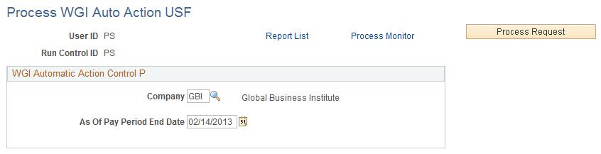

Use the Process WGI Auto Action USF page (RUN_FGHR002B) to specify automatic action run control parameters for processing WGIs.
Navigation:
This example illustrates the fields and controls on the Process WGI Auto Action USF. You can find definitions for the fields and controls later on this page.
Field or Control |
Description |
Company |
Enter the company for which you would like to process WGIs. |
As Of Pay Period End Date |
This field is set by default to the system date, but you must change it to a valid pay period end date for the pay calendar you have created. The system processes within-grade increases for employees with a WGI due date before this date, usually the begin date for the same pay period. However, the system also processes WGIs due before this pay period-retroactive WGIs. |
