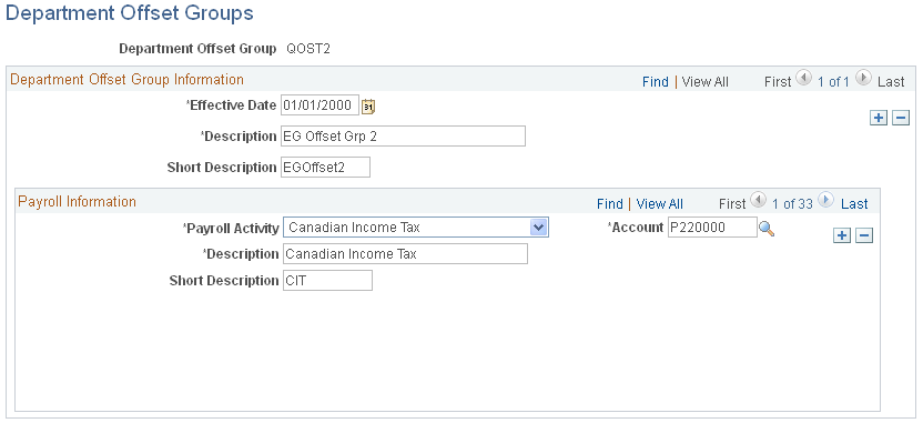

Use the Department Offset Groups page (DEPT_OFFSET_GRP) to establish offset groups to use as part of your department budgets.

This example illustrates the fields and controls on the Department Offset Groups page.

Payroll Activity |
Select a valid payroll activity. You can associate more than one activity with a Department Offset Group.Add a new row to add more activities. |
Account |
Enter a valid account code. The code you select is the funding source for all plan types in the selected Payroll Activity, unless otherwise specified. |
