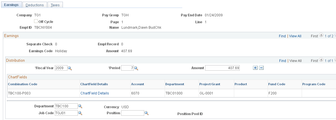

Use the Review Actuals Distribution - Earnings page (PAY_CHECK_DIST_ERN) to view and modify the actuals distribution after running the Actuals Distribution process and prior to posting to general ledger.
When you make changes on this page, the system performs an edit when you save the page to ensure that the total amount of earnings, deductions, and taxes redistributed compares to the paycheck totals.
Navigation:
This example illustrates the fields and controls on the Review Actuals Distribution - Earnings page.
Note: More of the page exists than is shown in the example. Scroll horizontally in the database to view fields in the entire CharfFields group box.
Field or Control |
Description |
Earnings |
Enter the amount of earnings to be distributed to this combination code in this accounting period. The sum of the earnings in the Distribution group box must equal the displayed Earnings amount for the Earnings group box. |
Account |
If earnings account mapping is enabled for the corresponding department budget, this field is available for entry. When the ChartField Details column is visible, it will contain a link to the page where the user may select a combination code or account value that determines the value of the Account field on the Earnings page. |

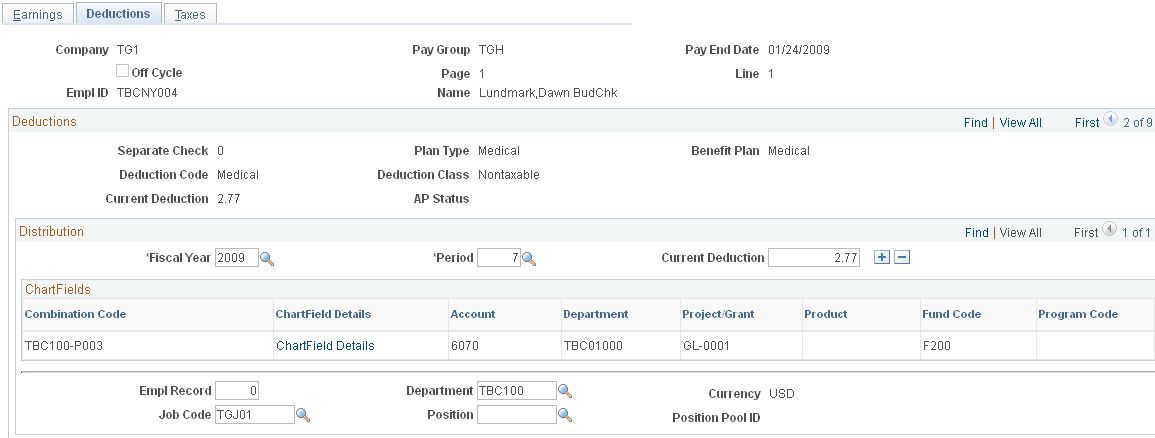

Use the Review Actuals Distribution - Deductions page (PAY_CHECK_DIST_DED) to view and modify the actuals distribution after running the Actuals Distribution process and prior to posting to general ledger.
Navigation:
This example illustrates the fields and controls on the Review Actuals Distribution - Deductions page.
Note: More of the page exists than is shown in the example. Scroll horizontally in the database to view fields in the entire Deductions group box.
Field or Control |
Description |
Current Deduction |
Enter the deduction amount to be distributed to this combination code in this accounting period. The sum of the deductions in the Distribution group box must equal the displayed Current Deduction in the Deductions group box. |
Account |
If deduction account mapping is enabled for the corresponding department budget, this field is available for entry. When the ChartField Details column is visible, it will contain a link to the page where the user may select a combination code or account value that determines the value of the Account field on the Deductions page. |

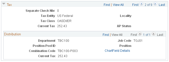

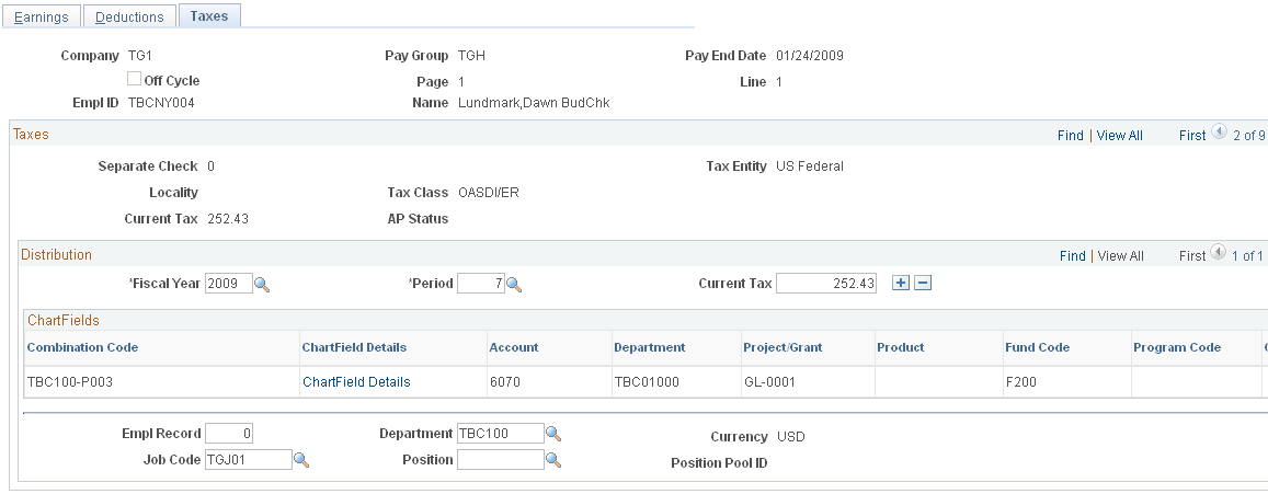

(USA, USF) Use the Review Actuals Distribution - Taxes page (PAY_CHECK_DIST_TAX) to view and modify the actuals distribution after running the Actuals Distribution process and prior to posting to general ledger.
Note: (CAN) The Review Actuals Distribution - Taxes page (PAY_CHECK_DIST_CTX) for Canada is similar to the page for USA.
Navigation:
This example illustrates the fields and controls on the Taxes page (1 of 2).
This example illustrates the fields and controls on the Taxes page (2 of 2).
Note: More of the page exists than is shown in the example. Scroll horizontally in the database to view fields in the entire ChartFields group box.
You can fund the tax from multiple combination codes by entering more than one row.
Field or Control |
Description |
Current Tax |
Enter the amount of the Current Tax to be funded by this combination code. The total of the values in the Current Tax field must equal the amount in the Current Tax field in the upper group box. |
Account |
If tax account mapping is enabled for the corresponding department budget, this field is available for entry. When the ChartField Details column is visible, it will contain a link to the page where the user may select a combination code or account value that determines the value of the Account field on the Taxes page. |
