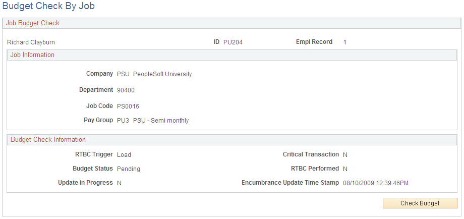

Use the Budget Check By Job page (HP_BDCK_JOB) to perform budget checking for job data.
Navigation:
This example illustrates the fields and controls on the Budget Check By Job page.
Review the transaction data, and select the Check Budget button to initiate the budget check.
Budget Check Information
Field or Control |
Description |
RTBC Trigger (real-time budget checking trigger) |
Displays the source component of the budget check transaction. |
Critical Transaction |
Displays Y (yes) if the last job data change was a critical transaction, or N (no) if it change was not critical. |
Budget Status |
Displays the current budget check status for the job: Valid or Invalid. |
RTBC Performed |
Displays Y (yes) if a real-time budget check has been performed, or N (no) if not. |
Update in Progress |
Displays Y (yes) if there is another real-time budget check transaction taking place for this job, or N (no) if not. |
Encumbrance Update Time Stamp |
Displays the date and time of the last encumbrance transaction. |
