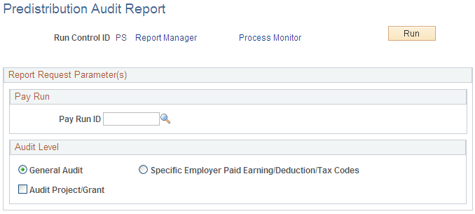

This example illustrates the fields and controls on the Predistribution Audit Report page.
Field or Control |
Description |
Pay Run ID |
Select the pay run ID of the pay run you will audit. |
General Audit |
Select to have the system verify that department budgets have been set up for the transactions in the selected pay run. |
Specific Employer paid Earning/Deduction/Tax Codes |
Select to have the system verify that department budgets have been set up for specific Earnings/Deductions/Tax codes for the transactions in the selected pay run. |
Audit Project/Grant |
Select to have the system verify that the project/grant ChartField specified in the combination code is valid. The system uses the project ChartField value from the ChartField Transaction Table component (ACCT_CD_TBL) to read the Project Table component (PROJECT). |
