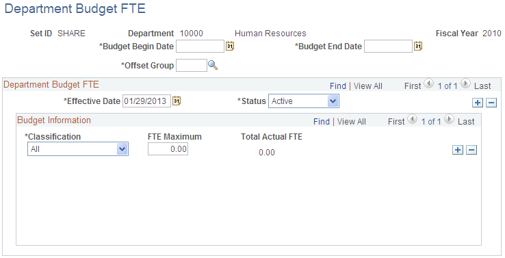

Use the Department Budget FTE (department budget full time equivalent) page (DEPT_BUDGET_FTE) to track FTE (full time equivalent) data.

This example illustrates the fields and controls on the Department Budget FTE page.
Specify how FTEs are allotted in each department and track FTE counts against a budgeted FTE amount.
Field or Control |
Description |
Budget Begin Date, Budget End Date, and Offset Group |
The budget begin date, budget end date, and offset group associated with this department. While you can use these fields to add a new fiscal year budget on this page, it won't be reflected in the Departments component (DEPARTMENT_TBL). Changes you make to existing fiscal year budgets when you enter the Department Budget FTE page in Correction mode are reflected on the Dept Budget Date page (DEPT_BUDGET_DATE). Create new fiscal year budgets only in the Department Budget Table component (DEPT_BUDGET/DEPT_BUDGET_CN). |
Classification |
Select the FTE classification:
FTE Maximum (full time equivalent maximum) |
Enter the FTE maximum for the department for each classification. Each department can designate whether they want to have an error, a warning, or no edit when the system compares the FTE actuals to the FTE maximums. Set up FTE warning messages on the Departments component by selecting the appropriate value for the FTE Edit Indicator. Select an Error, Warning, or No Edit. |
Total Actual FTE (total actual full time equivalent) |
The total actual full time equivalent counts based on information that you maintain on the Position Data and Job Data component for each FTE maximum and classification. |
