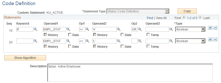

Use the Code Definition page (PA_CUSTOM_PNL) to define a pension status code.
Navigation:
This example illustrates the fields and controls on the Code Definition page.
A status code definition contains an IF statement that identifies the criteria for inclusion in this category—for example, the criteria for identifying active employees.
You must first set up the status code definitions on this page. Then, on the Status Code Assignment page, you assign a definition to each pension status code (you can reuse definitions, if appropriate).
Note: Because the pension status codes determine how participants are categorized for Form 5500 participant counts, be sure that your definitions categorize participants appropriately for regulatory reporting.
You do not need to use all of the valid pension status codes, but make sure that all participants belong to only one of the categories that you use. The statement type is always Status Code Definition.

Status code definitions can be complex. You can use the Copy button as a shortcut if you have multiple similar statements. To use it:
The system clones the original statement using the new name. You can then make minor adjustments to the new statement. If you must make major adjustments, consider creating a new definition instead. |

You can use IN clauses (that is, clauses with the keyword IN) to check for several different values for a single field. For example, you can determine whether the employee status has one of these values: active, leave, or leave with pay. When you use an IN clause, you assign a temporary variable to the result, as shown in this example:

You can set up as many IN clauses as necessary. Then, when you set up an IF statement, you check the temporary variables, as shown in this example:

This technique is useful when you check a large set of valid values. Because the IN statement uses an implied OR condition, it separates all of the OR clauses from the AND clauses of the final IF statement.
