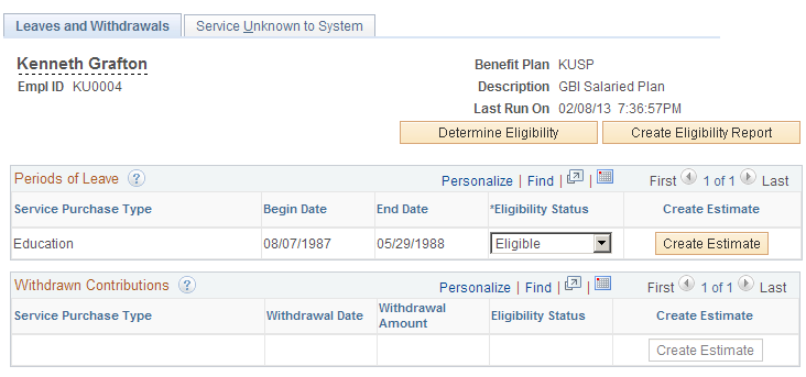

Use the Leaves and Withdrawals page (PA_SP_STP_PERIODS) to:
Identify an employee’s leave periods based on data from the PeopleSoft Human Resources system.
Identify an employee’s contribution withdrawals based on data from the pension system.
Navigation:
This example illustrates the Leaves and Withdrawals page.
Read-only fields at the top of the page identify the employee and plan for which you are identifying purchasable service.
Field or Control |
Description |
Last Run On |
Displays the date and time that you last ran the eligibility process. |
Determine Eligibility |
Click this button to run the eligibility process for each service purchase type shown in the component, including those on this page and on the Service Unknown to System page. Eligibility processes for specific plans and service purchase types are defined on the Service Purchase Configuration - Eligibility Page. |
Create Eligibility Report |
This button becomes active after you run the eligibility process by clicking the Determine Eligibility button. Click the Create Eligibility Report button to generate a letter to the employee summarizing the eligibility for the service purchase types shown in this component. The letter includes information about periods of leave, withdrawn contributions, and service unknown to the system. This letter is a report that is generated using Oracle Business Intelligence Publisher (BI Publisher). The report definition is SPELIGLTR. |
Periods of Leave
The system populates the Periods of Leave grid by comparing the employee’s action/reason history to the actions and reasons for the plan’s service purchase types, as configured on the Service Purchase Type Page.
Field or Control |
Description |
Service Purchase Type |
Displays the service purchase type for the leave period in the employee’s action/reason history. |
Begin Date and End Date |
Displays the beginning and ending date of the leave period as established by the employee’s action/reason history. |
Eligibility Status |
Initially, the Eligibility Status is Undetermined. When you click the Determine Eligibility button, the system changes this value to either Eligible or Ineligible. If the Eligibility Override Allowed check box is selected on the Service Purchase Configuration - Eligibility page, this field is editable. Otherwise, it is read-only. |
Create Estimate |
If a leave period is determined to be eligible for service purchase, the Create Estimate button becomes active. Clicking this button creates a new service purchase record and transfers you to the Purchase Service page, where you can calculate costs and benefits and create and manage service purchase estimates. |
Withdrawn Contributions
The system populates the Withdrawn Contributions Leave grid by looking at the employee’s withdrawal subaccount under the plan’s employee account. Only withdrawals that resulted in forfeited service are shown.
Field or Control |
Description |
Displays Withdrawn Contributions, which is the delivered service purchase type for contribution withdrawals. |
Withdrawal Date |
Displays the date that the employee withdrew contributions. |
Withdrawal Amount |
Displays the amount of money withdrawn. |
Create Estimate |
If a withdrawal of contributions is determined to be eligible for service purchase, the Create Estimate button becomes active. Clicking this button creates a new service purchase record and transfers you to the Service Purchase page, where you can calculate costs and benefits and create and manage service purchase estimates. |

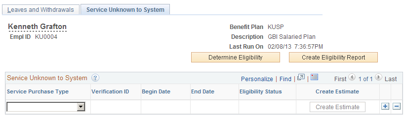

Use the Service Unknown to System page (PA_SP_STP_UNKNOWN) to enter a service purchase period that is not shown on the Leave and Withdrawals page.
Navigation:
This example illustrates the Service Unknown to System page.
Field or Control |
Description |
Click this button to run the eligibility process for each service purchase type shown in the component, including those on this page and on the Leaves and Withdrawals page. Eligibility processes for specific plans and service purchase types are defined on the Service Purchase Configuration - Eligibility Page. |
Field or Control |
Description |
Enter the purchase service type for the leave period. You can select service purchase types that are action/reason enabled, but you cannot select the delivered withdrawal contribution type. Withdrawn contributions have special processing, and this value should not be used for entries of Service Unknown to system. If you want to purchase withdrawn contributions using the Service Unknown to System option, you must create a new service purchase type for this. However, be aware that a service purchase account, not a withdrawal account, will be used to store the balance. |
Verification ID |
Optionally identify the ID for an employment history verification record. Only records with the status Verified are available for selection. |
Enter the begin and end dates of the period for which service may be purchased. If you entered a verification ID, the begin and end date for the verified employment are used as default values for the service purchase type begin and end date. |
Create Estimate |
If the service purchase type is determined to be eligible for service purchase, the Create Estimate button becomes active. Clicking this button creates a new service purchase record and transfers you to the Service Purchase page, where you can calculate costs and benefits and create and manage service purchase estimates. |

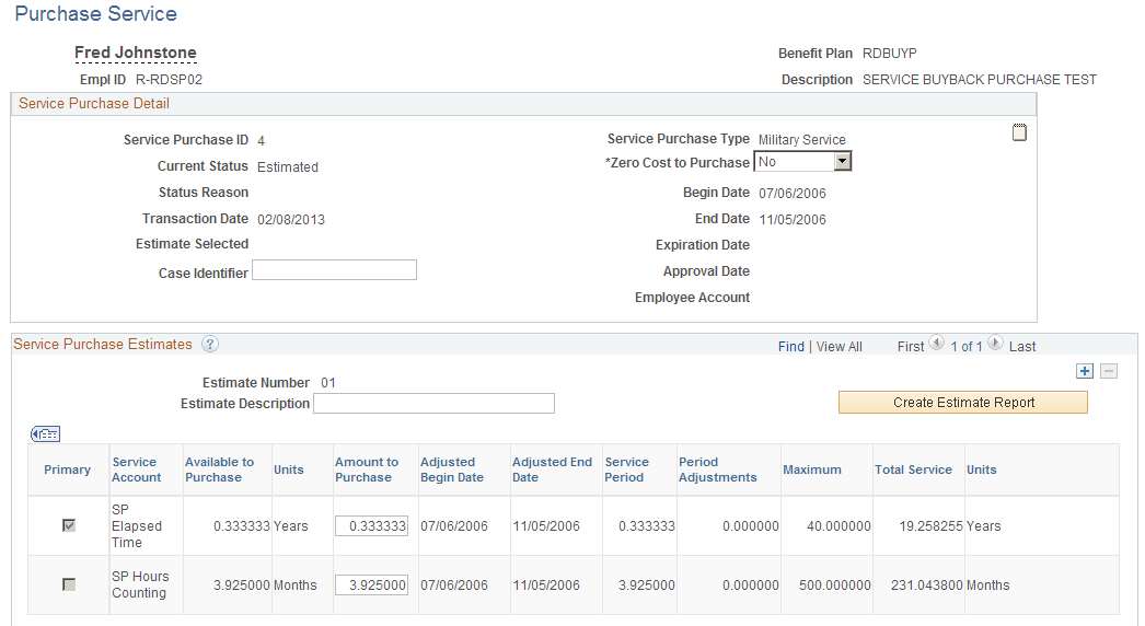

Use the Purchase Service page (PA_SP_SVC_COST_BEN) to administer a service purchase transaction.
Navigation:
To create a service purchase transaction, click the Create Estimate button on the Leaves and Withdrawals page or the Service Unknown to System page.
To manage an existing service purchase transaction, select
This is the first of two examples illustrating the Purchase Service page.
In this example, the grid that lists service is showing all columns. However, it is a tabbed grid in default state.
This is the second of two examples illustrating the Purchase Service page.
Note: All fields on this page become read-only when the status changes from Estimate to Submitted.
Service Purchase Detail
Field or Control |
Description |
Service Purchase ID |
Displays the system-generated unique identifier for the service purchase transaction. |
Current Status |
Displays the status of the service purchase transaction. You can manually set this status using the Status field at the bottom of this page. |
Status Reason |
Displays the status reason for the current status. To manually assign a reason, use the enterable Status Reason field at the bottom of this page. |
Transaction Date |
Displays the date this service purchase transaction was created. |
Estimate Selected |
A service purchase transaction can have multiple estimates that model different options. Only one estimate, however, can be submitted. When you submit an estimate, the Estimate Selected field displays the numeric identifier of the submitted estimate. |
Verification ID |
If the estimate includes service that you entered on the Service Unknown to System page, and if that service is associated with an employment verification record, this field displays the unique identifier for that verification record. |
Case Identifier |
This field is visible only if the Display Case Identifier check box is selected on the Pension Installation Page. You can manually enter a case number to match this verification request with a case in your employee help desk system. The case number is informational only. |
Displays the service purchase type for the transaction. |
Zero Cost to Purchase |
This field is visible only if the Allow Zero Cost check box is selected on the Service Purchase Configuration - Cost Page. The initial value is No, but you can change the value to Yes to reinstate service at no cost to the employee. When you select Yes, the Service Purchase Cost field on this page becomes read-only and displays a zero value. Service adjustments are automatically applied when the status of the purchase is updated to Elected, and after the service adjustments are applied, the system updates the status to Complete. |
Displays the beginning and ending date of the leave period for which the employee is purchasing service. If the service purchase type is Withdrawn Contributions, these fields are blank. |
Expiration Date |
Displays the date when the service purchase estimate is no longer valid if it has not yet been elected. The system sets the expiration date at the time the estimate is submitted. The length of time that an estimate remains valid after submission is determined by the Expiration Duration fields on the Service Purchase Configuration - Parameters Page. |
Approval Date |
Displays the date, if any, that the service purchase was put into Approved status. |
Employee Account |
After the service purchase transaction is submitted, this field displays the employee account where purchase payments are entered. This account is a service purchase account or a withdrawal account, depending on the service purchase type. |
Create Purchase Agreement |
This button is visible if the agreement is in Submitted status. Click to generate a purchase agreement letter to send to the employee. This letter is a report that is generated using Oracle BI Publisher. The report definition is SPFNLAGRLTR. |
View Payments |
This link is visible if the agreement is in Elected status. Click to open the Review Payments Page in a modal window so that you can review payments. |
