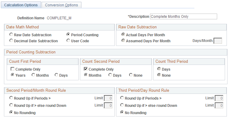

Use the Calculation Options page (PA_AGECALC_PERIOD) to choose a calculation method and set parameters associated with the method.
Navigation:
This example illustrates the fields and controls on the Calculation Options page.
Date Math Method
Select one of the following date math methods:
Raw Date Subtraction
Also select options in the Raw Date Subtraction, Second Period/Month Round Rule, and Third Period/Day Round Rule group boxes.
Period Counting
Also select options in the Period Counting Subtraction, Second Period/Month Round Rule, and Third Period/Day Round Rule group boxes.
Decimal Date Subtraction
User Code
Convert months to days in order to perform subtractions when the earlier date has fewer days than the later date. For example:
  1990/11/06
- 1977/12/13

Period Counting
If you choose the period counting method, you need to indicate the period or periods to count. You can count either one type of period, such as years, or you can count successively shorter periods, such as years and then months.
You can define up to three types of counting periods: years, months, and days. You can use any combination of these periods, but you must use them in order: from longest to shortest.
Although you may not want to express shorter units in the final count, you may still want to count them for rounding purposes. For example, if you are only going to count years, but you are going to round by months, you also need to count months.

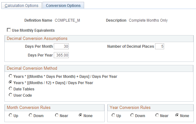

Use the Conversion Options page (PA_AGECALC_PARMS) to set up a raw date to decimal date conversion method.
Navigation:
This example illustrates the fields and controls on the Conversion Options page.
Unless your source dates are decimal dates, the system converts the raw dates or durations to decimal dates. If you use raw date subtraction or period counting, the system converts the duration after performing the date math. If you use decimal date subtraction, the system converts the endpoints before performing the subtraction.
When you convert raw dates and durations to decimal equivalents, you have to convert months and days to partial years. There are a number of ways to do this. Specify your conversion options in the Decimal Conversion Assumptions and Decimal Conversion Method group boxes.
Specify your assumptions about the number of days in a month and in a year. The system uses these values to convert dates to decimal values.
