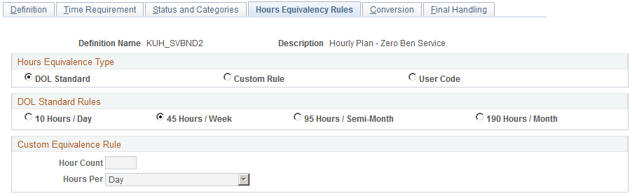

Hours equivalence definitions assign a specific number of hours per time period worked. For example, if the equivalence rate is 45 hours per week, an employee who is in service status for an entire year receives credit for 53 weeks (52 whole weeks and one partial week), or 2,385 hours.
The system uses an employee's service status to determine whether or not to credit hours. It uses the action and reason codes in the employee's job record to determine the employee's service status.
Use the Hours Equivalency Rules page (PA_SVC_HREQV) to specify how much credit to give for what time periods.
Navigation:
This example illustrates the fields and controls on the Service-Hours Equivalence - Hours Equivalency Rules page.
Hours Equivalence Type
Field or Control |
Description |
DOL Standard |
Select this option if you use the Department of Labor (DOL) minimum requirements. Also, select from the options in the DOL Standard Rules group box. |
Custom Rule |
Select this option if you want to enter some other number of hours per period. Also, compete the Custom Equivalence Rules group box: |
Field or Control |
Description |
Hour Count and Hours Per |
Enter the number of hours and select one of these values in the Hours Per field:
