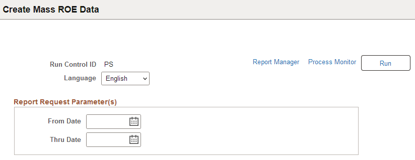

(CAN) Use the Create Mass ROE Data page (RUNCTL_FRMTHRU_PAY) to run PAY124CN, which creates ROE data automatically for a range of dates.
Navigation:
This example illustrates the fields and controls on the Create Mass ROE Data page.
Enter the date range that defines the activity period from which the system selects employees qualifying for a ROE.

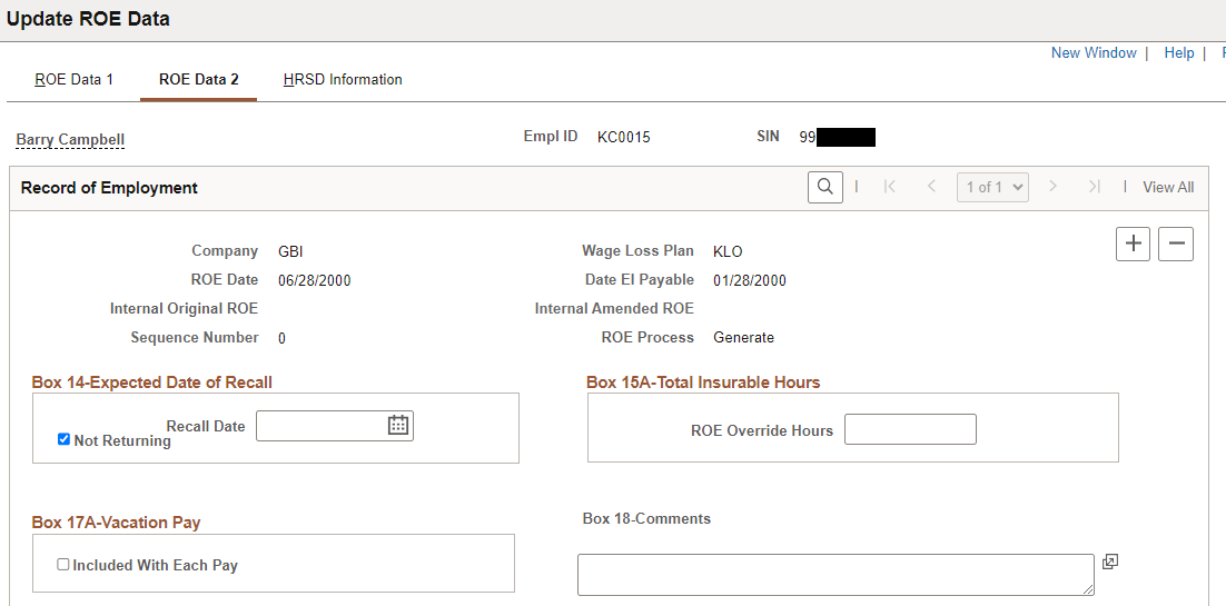

(CAN) Use the ROE Data 2 (Record of Employment data 2) page (ROE_DATA2) to enter more employment-related details, after you finish entering data on the ROE Data 1 page.
Navigation:
This example illustrates the fields and controls on the ROE Data 2 page (1 of 2).
This example illustrates the fields and controls on the ROE Data 2 page (2 of 2).
Box 14-Expected Date of Recall
Field or Control |
Description |
Recall Date |
Enter the expected return date as entered in the Employment Data record. |
Not Returning |
Select this check box if the employee is not returning to work (for example, the employee is retired or terminated). If the Not Returning check box is deselected and the Recall Date field is empty, the system selects the Unknown check box in block 14 on the ROE form. |
Box 15A-Total Insurable Hours
Field or Control |
Description |
ROE Override Hours (Record of Employment override hours) |
Enter the ROE override hours if you must correct the ROE insurable hours. |

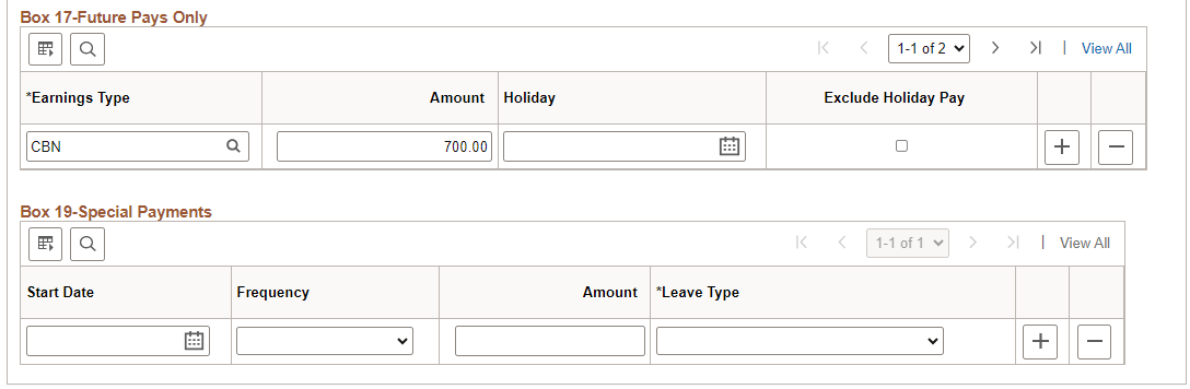

Box 17A-Vacation Pay
Select the Included With Each Pay check box if vacation pay is included in paychecks each pay period.
Box 17-Future Pays Only
Enter earnings paid to the employee after the employee's final pay period.
Field or Control |
Description |
Earnings Type |
You must define the earnings code on the Tax Form Definition page. |
Amount |
Enter the amount that you paid to the employee after the final period. The system does not automatically add this amount to balances for year-end reporting. When you use this field, you are responsible for ensuring that the applicable balance records are updated to reflect these amounts. |
Holiday |
This field is used for box 17B, Statutory Holiday. |
Exclude Holiday Pay |
Select the Exclude Holiday Pay check box to exclude the amount reported for Statutory Holiday on ROE Data Block 17B from adding it to Block 15C (1). Deselect the Exclude Holiday Pay check box to include the amount in Statutory Holiday on ROE Data Block 17B to Block 15C (1). By default, this check box is deselected. |
Block 17 on the ROE form reports payments or benefits (other than regular pay) paid in, or in anticipation of the final pay period, or payable at a later date.
The following table describes how the system reports the earnings. You must first define all earnings on the Tax Form Definitions page (TAXFORM_DEFN_TBL):
Box |
Earnings Paid in Final Pay Period |
Earnings Paid After Final Pay Period |
Box 17A Vacation Pay |
Earnings are reported in boxes 15C. |
You must select the check box in Box 17A to indicate that vacation pay for the employee is included in every pay period. You must enter additional vacation earnings manually on the ROE Data 2 page, Box 17. These earnings are reported in Box 15C. |
Box 17B Statutory Holiday Pay |
For the earnings to be reported in box 17B, you must also enter the same earnings information on the ROE Data 2 page. |
You must enter the earnings manually on the ROE Data 2 page, box 17. These earnings are reported in box 17B only. You must enter the date of the holiday for which the employee is paid. |
Box 17C Other Monies |
Earnings are reported in boxes 15C and 17C. |
You must enter the earnings manually on the ROE Data 2 page, box 17. These earnings are reported in box 15C and 17C. |
Box 18-Comments
These comments appear in block 18 on the ROE form. Use Box 18 only in extenuating circumstances where the reason codes provided are not sufficient to explain the need to issue a ROE. Comments entered in this box usually cause Service Canada to process the claim manually, delaying processing time.
Box 19-Special Payments
This group box corresponds to block 19 on the ROE form. Complete these fields only if the employee receives paid sick, maternity, parental leave, or group wage loss indemnity payments after the last day worked. These fields appear on the ROE form as you enter them here. The system does not validate them.

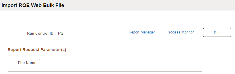

(CAN) Use the Import ROE Web Bulk File page (RUNCTL_PAY107CN) to import Service Canada serial numbers and amended serial numbers into the PeopleSoft system from the ROE Web bulk transfer file from Service Canada.
Navigation:
This example illustrates the fields and controls on the Import ROE Web Bulk File page.
Field or Control |
Description |
File Name |
Enter the filename of the applicable ROE Web bulk file from Service Canada. |
The Import ROE Web Bulk File (PAY107CN) process enables you to import Service Canada serial numbers and amended serial numbers into the PeopleSoft system from the ROE Web bulk transfer file from Service Canada. It matches the PeopleSoft ROE data records with the records in the Service Canada web ROE bulk file. Prior to running this process, download the XML import file from Service Canada and save it to the PeopleSoft import directory specified in setenv.sqc.
The bulk transfer file from Service Canada may contain four types of ROEs (Issued, Rejected, Failed, or Passed) that are processed by PAY107CN as follows:
Issued: ROEs in the Service Canada file are set to an ROE Process status of Complete on the ROE Data 1 page and the serial number assigned by Service Canada is entered into the ROE Serial Number or Amended ROE Serial Number field on the HRSD Information page of the ROE Data component.
Rejected: ROEs in the Service Canada file are set to an ROE Process status of XML File Rejected on the ROE Data 1 page. The process also clears the PeopleSoft internal ROE number and updates the ROE insurable earnings to reflect a blank internal ROE number.
Failed: ROEs in the Service Canada file are set to an ROE Process status of XML File Failed on the ROE Data 1 page. The process also clears the PeopleSoft internal ROE number and updates the ROE insurable earnings to reflect a blank internal ROE number.
Passed: ROEs are ignored for processing as PeopleSoft does not support ROEs that are stored as Draft in the Service Canada ROE Web system. The process generates a warning message to identify Passed ROEs that were ignored for processing.
Rejected and Failed ROEs should be corrected and re-exported for submission to Service Canada.
See Record of Employment on the Web (ROE Web) - User Requirements on the Service Canada web site. As of the date of this publication, see Appendix C - Import XML File Format Specification.

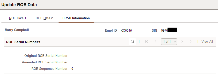

(CAN) Use the HRSD Information page (ROE_DATA3) to view the ROE serial numbers from the Service Canada.
Navigation:
This example illustrates the fields and controls on the HRSD Information page.
Field or Control |
Description |
Original ROE Serial Number |
Displays the ROE serial number that is provided by the Service Canada in the ROE Web import file. |
Amended ROE Serial Number |
Displays the amended ROE serial number that is provided by the Service Canada in the ROE Web import file. |
ROE Sequence Number |
When the Create Mass ROE Data (PAY124CN.SQR) runs, the system assigns a sequential number to identify different versions of an amended ROE. The same field appears on the ROE Data 1 page. |
