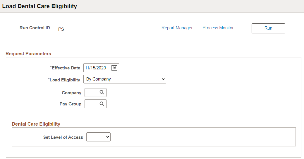

Use the Load Dental Care Eligibility page (RUNCTL_CTX905DP) to load dental care access level information for selected individuals.
Navigation:
This example illustrates the fields and controls on the Load Dental Care Eligibility page.
Note: Component Interface is delivered for the Dental Care Eligibility component as an alternative to load dental care access level codes for individuals using the Excel to CI utility.
Field or Control |
Description |
Load Eligibility |
Select the method used to identify individuals for whom a dental care access level code is assigned. Values are: By Company. By Group ID. For Selected Individuals. Use this option to update the level of access value for a small group of people. |
Company and Pay Group |
Specify the company and optionally pay group used to identify individuals for the loading process. These fields appear if the By Company option is selected. |
Group ID |
Specify the group ID used to identify individuals for the loading process. This field appears if the By Group ID option is selected. Groups are defined using Group Build. You can use this feature to create groups of people, for example, union workers. Refer to Understanding Group Build and Setting Up Group Definitions for more information on the Group Build feature and how to define groups. |
Individual(s)
This section appears if the For Selected Individuals option is selected.
For each individual to include in the loading process, select the company, employee ID, employee record, and the level of dental care access to be assigned.
Field or Control |
Description |
Set Level of Access |
Select the level of dental care access to assign to identified individuals. Values are: 1 (No Dental Access or coverage) 2 (Payee) 3 (Payee, Spouse and Dependents) 4 (Payee and Spouse) 5 (Payee and Dependents) |

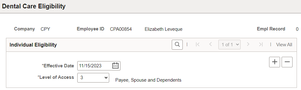

Use the Dental Care Eligibility page (DENTAL_ELIG_CAN) to manage dental care access level information for individuals.
Navigation:
This example illustrates the fields and controls on the Dental Care Eligibility page.
After the Load Dental Care Eligibility (CTX905DP) process has completed successfully, the assigned dental care access level for each identified individual becomes available on the Dental Care Eligibility page. Add or update this information as needed.
