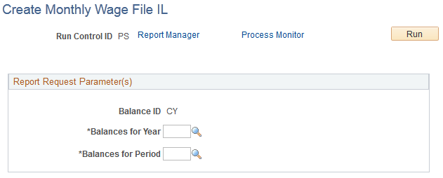

Use the Create Monthly Wage File IL run control page to run the TAX812IL.SQR process. The process generates monthly wage data electronically, in a comma separated (.csv) plain ASCII text format file, which is the reporting format required by the State of Illinois. In addition to the monthly wage reporting file, the program also produces a report summarizing the information contained in the file.

Use the Create Monthly Wage File IL (RUNCTL_TAX812IL) to generate electronic files and print monthly payroll reports for Illinois.

This example illustrates the fields and controls on the Create Monthly Wage File IL page.
