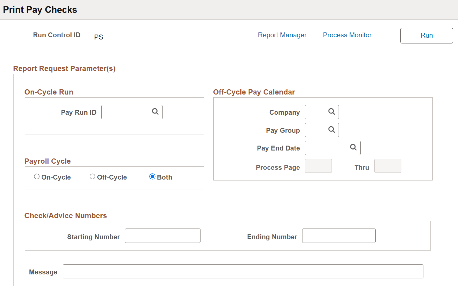

(USA, USF) Use the Print Pay Checks page (RUNCTL_CHK_ADV1) to print U.S. paychecks by the SQR method using the Pay Check Print - US SQR process (PAY003).
(CAN) Use the Print Paycheques page (RUNCTL_CHK_ADV) to print Canadian paycheques by the SQR method using the Pay Cheque Print - Canada SQR process (PAY003CN).
Navigation:
This example illustrates the fields and controls on the Print Pay Checks page.
Note: (CAN) Although the Canadian page displays with some differences, all fields have the same functionality as the fields shown on the U.S. page.
Note: The Print Pay Checks page is shown here as an example; all of the run control pages used for printing checks and direct deposit reports by the SQR method use the same parameters.
On-Cycle Run
If you specify only a pay run ID, the system selects checks from that run ID that are based on a payroll cycle of only on-cycle, off-cycle, or both.
If you specify a pay run ID and the check range, the system selects only the checks that are in the check number range and based on a payroll cycle of only on-cycle, off-cycle, or both.
Off-Cycle Pay Calendar
If you use this group box, you must enter:
Company
Pay group
Pay end date
Available fields and completed tasks depend on which option you select in the Payroll Cycle group box:
Payroll Cycle
Field or Control |
Description |
On-Cycle |
The page number fields are unavailable for entry. The system selects only the on-cycle checks for the company and pay group with the pay end date that you specify. If you specify a check number range, the system selects only those checks. |
Off-Cycle |
The page number fields are available for entry. The system selects only the off-cycle checks for the company and pay group with the pay end date that you specify. If you specify the page number range, the system selects all checks in that page range. If you specify a check number range, the system selects only those checks. |
Both |
The page number fields are available for entry. The system selects both off-cycle and on-cycle checks for the company and pay group with the pay end date that you specify. If you specify the page range, the system selects all checks in that page range. If you specify a check number range, the system selects only those checks. |
Check/Advice Numbers
Specify a check or advice number range to print only the specified checks or advices.

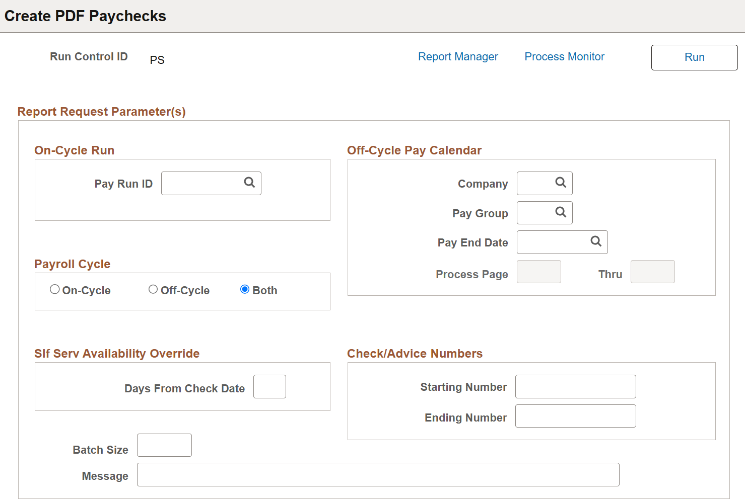

(USA, USF) Use the Create PDF Paychecks page (RUNCTL_CHK_ADV1_EP) to create U.S. paychecks in PDF for printing and self-service viewing using the Print US Checks PSJob process (PYCHKUSA).
(CAN) Use the Create PDF Paycheques page (RUNCTL_CHK_ADV_EP) to create Canadian paycheques in PDF for printing and self-service viewing using the Print Canadian Cheques process (PYCHQCAN).
Navigation:
This example illustrates the fields and controls on the Create PDF Paychecks page.
Note: The Create PDF Paychecks page is shown here as an example; all of the run control pages used for creating checks and direct deposit reports by the BI Publisher method use the same parameters.
Note: The paycheck data from the current pay run is visible to employes in self service as soon as you run pay confirmation. Running the BI Publisher PDF creation process uses the Paycheck Availability fields on the Paycheck Options Table Page for the PDF paycheck to determine when the PDF check is viewable in self service. For this reason, Oracle recommends that you run the BI Publisher PDF creation process immediately after confirming the payroll. If you are not using the BI Publisher PDF creation process, you can still define the Paycheck Availability fields on the Paycheck Options Table page to determine when the check will be viewable in self service for non-PDF wage statements.
The run parameters for the BI Publisher processes are identical to the parameters for the SQR processes with the addition of these options:
Slf Srvc Availability Override
Field or Control |
Description |
Days From Check Date |
Leave this field blank to retain the default value entered on the Paycheck Options Table page. To override the value on the Paycheck Options Table for this check or advice print run, enter a different number of days from check date. The system issues a confirmation message if you enter an override. If you do not confirm the override, the system does not save the value you entered and the field remains blank. |
Batch Size |
Enter the number of individual paychecks that you want to batch together into one PDF print file. You can determine the optimum file size in your environment. |
Process Scheduler Settings
On the Process Request page, select the type Web and the format PDF.
If you ran one of the PDF creation processes to print PDF checks or advice forms through BI Publisher, you must use the Report Manager to view the PDF print files.

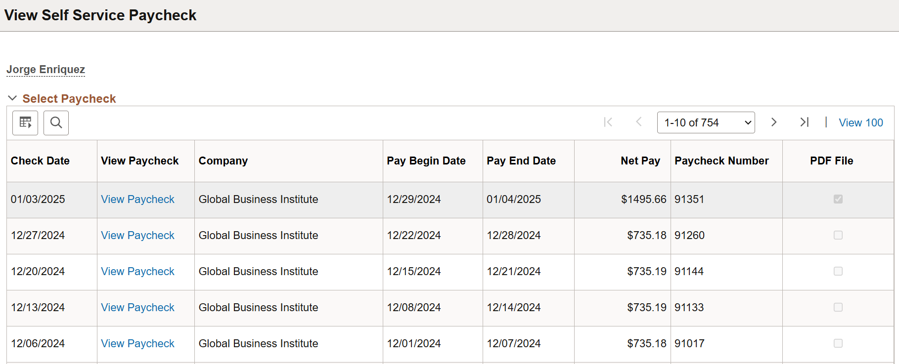

This example illustrates the fields and controls on the View Self Service Paycheck page.
The payroll administrator searches by employee ID on the search page to locate a particular employee's paychecks.
Field or Control |
Description |
View Paycheck |
Click to access the check of the associated check date on the View Self Service Paycheck page (PY_SSP_VIEW_DATA). PDF checks open in a new window. The system displays non-PDF checks on the View Self Service Paycheck page (PY_SSP_VIEW_DATA). The View Self Service Paycheck page has a similar layout as the View Paycheck Page that is available to employees to view their own paycheckcs in Fluid. |
PDF File |
The system selects this for checks displayed in PDF. In accessible mode, the system always displays checks on a PeopleSoft page (and not in a PDF file). Therefore, this column is hidden in screen reader mode. |
