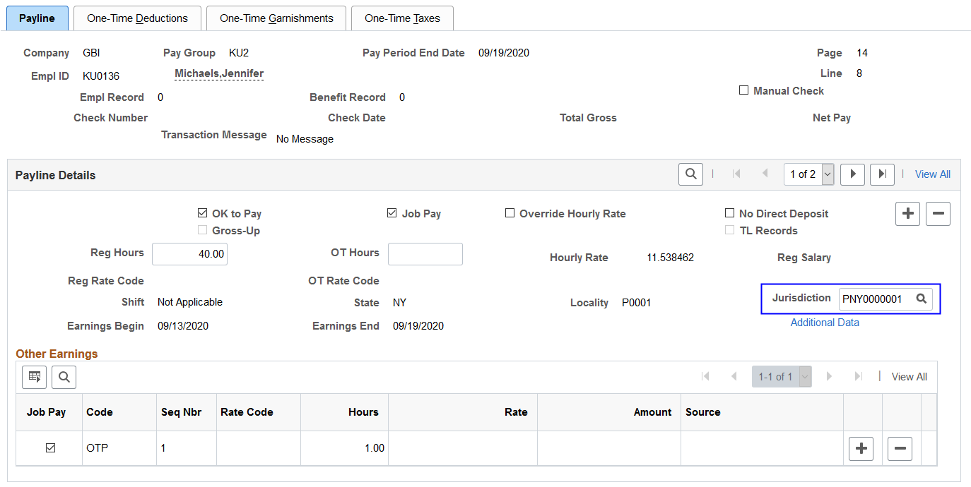

When a payline is being created or updated, the system identifies the default jurisdiction of an employee using this logic and priority sequence:
If both the state and locality values are present on the payline, the system:
Finds the matching locality setup for the employee on the Update Minimum Wage Jurisdiction Page and uses the corresponding jurisdiction as the default value.
(If no default value can be found from the previous step) Finds the matching locality setup on the Locality/Jurisdiction Mapping Page and uses the corresponding jurisdiction as the default.
(If no default value can be found from the previous step) Leaves the Jurisdiction field blank. No defaulting occurs.
If the locality value is not present on the payline, the system uses the employee’s location from Job Data instead. It:
Finds the matching location setup for the employee on the Update Minimum Wage Jurisdiction Page and uses the corresponding jurisdiction as the default value.
(If no default value can be found from the previous step) Finds the matching location setup on the Location/Jurisdiction Mapping Page and uses the corresponding jurisdiction as the default.
If no default value can be found from the previous step, the system uses the employee’s state on the payline. It finds the matching state setup for the employee on the Update Minimum Wage Jurisdiction Page and uses the corresponding jurisdiction as the default value.
If no default value can be found from the previous step, the system leaves the Jurisdiction field blank. The state’s minimum wage rate will be used.
The default jurisdiction, if found, is populated on employee’s payline; the Payroll administrator can manually update the value as needed.
This example illustrates the default jurisdiction that is populated for an employee on a payline.
Note: The jurisdiction value is also available on pages where payline information is displayed, for example, Paysheet pages, Paycheck Earnings pages, Review FLSA Pay Data page, Create Online Check page, and so on.
Example of Default Jurisdiction 1

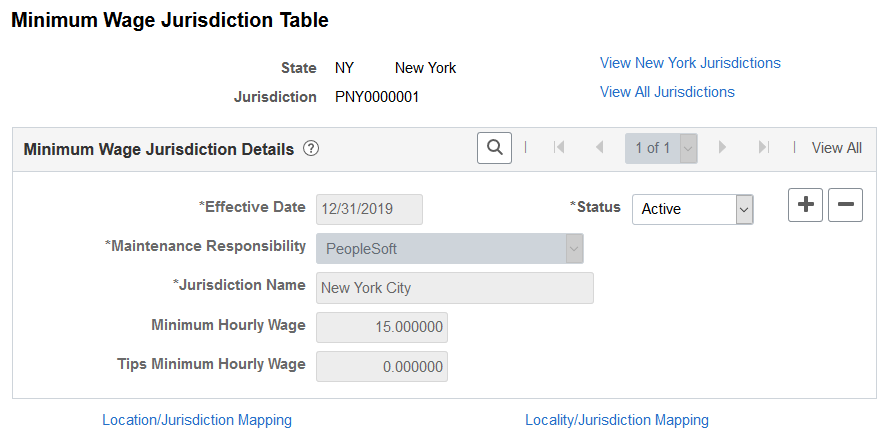

Use the Minimum Wage Jurisdiction Table page (PY_JUR_MW) to define minimum wage information for jurisdictions by state.
Navigation:
This example illustrates the fields and controls on the Minimum Wage Jurisdiction Table page.
Use this section to set up minimum wage data for state jurisdictions that observe different minimum wage rates than their state rate.
Field or Control  |
Description  |
State and Jurisdiction  |
 Displays the state and the code of the jurisdiction. State codes prefixed with $ are not available for selection. A jurisdiction can be a city, municipality, county, region, or any local government body in a state that establishes and administers minimum wage legislation. Note: PeopleSoft-delivered jurisdiction codes are prefixed with the letter “P”. Do not use this prefix when creating customer-maintained codes. If the same minimum wage information for a jurisdiction exists in a PeopleSoft row and a customer row for the same effective date, the system uses the customer row for minimum wage processing.  |
View <US State> Jurisdictions  |
 Click to access the View <US State> Jurisdictions Page to review minimum wage information entered for jurisdictions of the specified state.  |
View All Jurisdictions  |
 Click to access the View All Jurisdictions Page to review minimum wage information entered for all jurisdictions.  |
Maintenance Responsibility  |
 Displays: PeopleSoft if the row is delivered by PeopleSoft. All fields, except for the Status field, are not editable. Customer if the row is added by a customer.  |
Minimum Hourly Wage  |
 Enter the minimum wage rate for the jurisdiction. The system considers the value to be zero if the field is blank.  |
Tips Minimum Hourly Wage  |
 This field value is informational only.  |
Location/Jurisdiction Mapping  |
 Click to access the Location/Jurisdiction Mapping Page to map locations to minimum wage jurisdiction.  |
Locality/Jurisdiction Mapping  |
 Click to access the Locality/Jurisdiction Mapping Page to map localities to minimum wage jurisdiction.  |

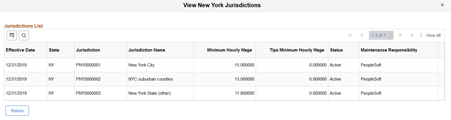

Use the View <US State> Jurisdictions page (PY_JUR_ALL_SEC) to review minimum wage information entered for jurisdictions of the specified state.
Navigation:
Click the View <US State> Jurisdictions link on the Minimum Wage Jurisdiction Table page.
This example illustrates the fields and controls on the View <US State> Jurisdictions page.
Review a list of minimum wage data for jurisdictions of the specified state (both current and future-dated rows). You can download the information to an Excel file if needed.

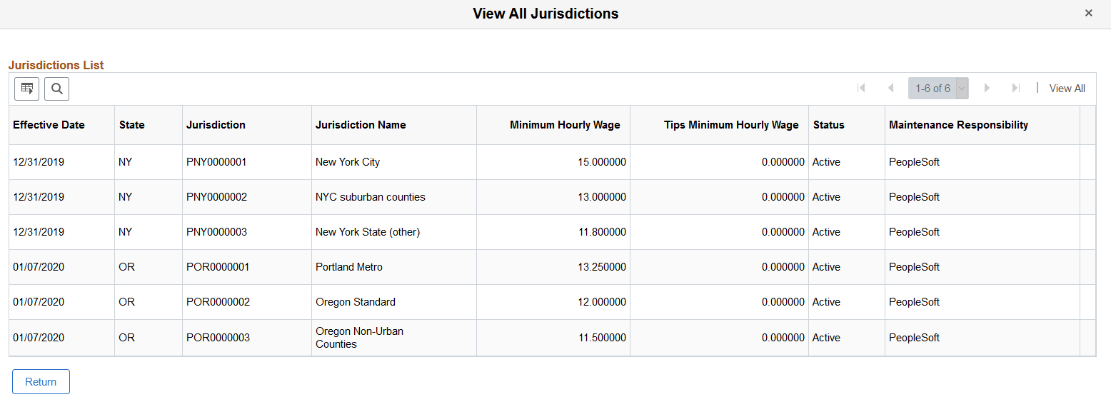

Use the View All Jurisdictions page (PY_JUR_ALL_SEC) to review minimum wage information entered for all jurisdictions.
Navigation:
Click the View All Jurisdictions link on the Minimum Wage Jurisdiction Table page.
This example illustrates the fields and controls on the View All Jurisdictions page.
Review a list of minimum wage data for all jurisdictions in the system (both current and future-dated rows). You can download the information to an Excel file if needed.

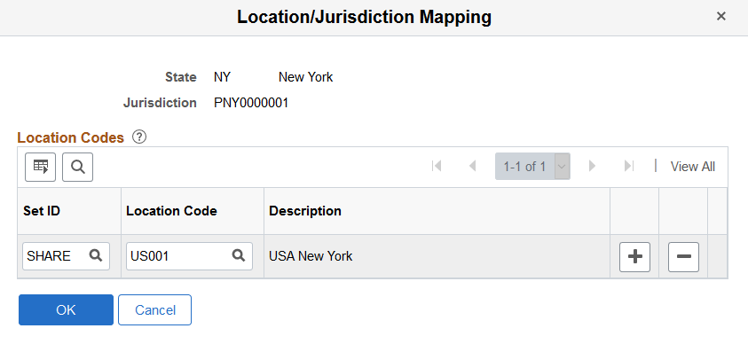

Use the Location/Jurisdiction Mapping page (PY_JUR_LOCN_SEC) to map locations to jurisdiction minimum wage information.
Navigation:
Click the Location/Jurisdiction Mapping link on the Minimum Wage Jurisdiction Table page.
This example illustrates the fields and controls on the Location/Jurisdiction Mapping page.
Field or Control  |
Description  |
Location Code  |
 A location code can be mapped to one jurisdiction code only. You can map one or more location codes to the same jurisdiction code. If the system cannot identify the employee’s jurisdiction using the jurisdiction minimum wage setup of the employee or the locality jurisdiction mapping on the Locality/Jurisdiction Mapping Page, it uses the employee’s job location to find the associated jurisdiction in this mapping to be defaulted on the employee’s payline.  |

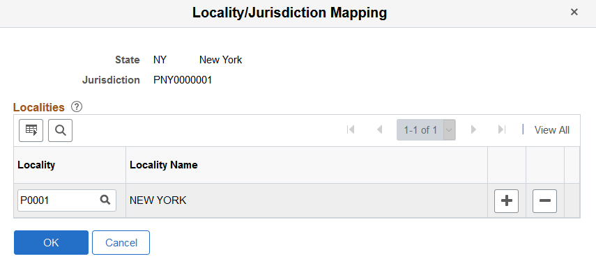

Use the Locality/Jurisdiction Mapping page (PY_JUR_LOC_SEC) to map localities to jurisdiction minimum wage information.
Navigation:
Click the Locality/Jurisdiction Mapping link on the Minimum Wage Jurisdiction Table page.
This example illustrates the fields and controls on the Locality/Jurisdiction Mapping page.
Field or Control  |
Description  |
Locality  |
 A locality code can be mapped to one jurisdiction code only. You can map one or more locality codes to the same jurisdiction code. If a locality is present on the employee’s payline, and the system cannot identify the employee’s jurisdiction using the jurisdiction minimum wage setup of the employee, it finds the associated jurisdiction of the locality in this mapping to be defaulted on the payline.  |

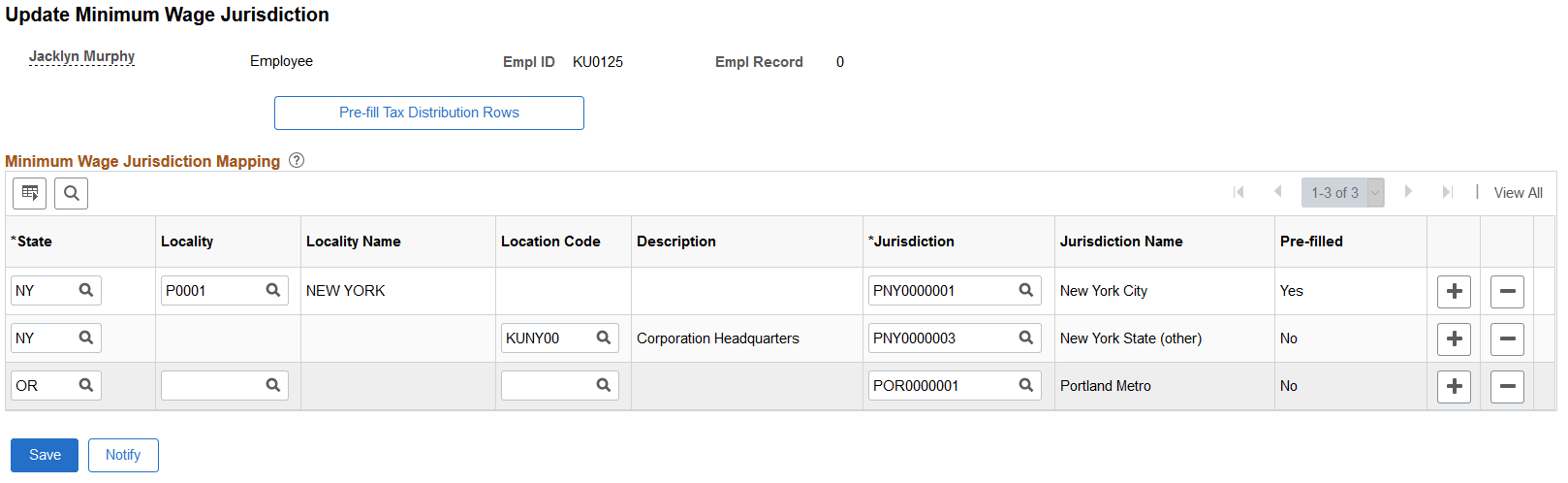

Use the Update Minimum Wage Jurisdiction page (PY_JUR_MW_EMPDATA) to map employees to jurisdictions using localities, locations, and state.
Navigation:
This example illustrates the fields and controls on the Update Minimum Wage Jurisdiction page.
Use this page to map a default jurisdiction to a state and locality combination, a state and location combination, or a state for the employee.
Note: It is the customer’s responsibility to maintain the data on the Update Minimum Wage Jurisdiction page. The system does not update this page automatically based on Job Data Location, Tax Location or employee tax data changes.

Pre-fill Tax Distribution Rows  |
 Click this button to prepopulate current tax distribution rows for the employee. The system removes all prefilled rows in the grid, and populates it with current rows from tax distribution again. It populates only rows for states that are set up to support minimum wage for jurisdictions. Future-dated information from the Tax Distribution table is not included. Each added row displays the state or state and locality, which are editable. The Pre-filled field is set to Yes and it is read-only.  |
State  |
 Specify the US state for the jurisdiction mapping. Only states with minimum wage setup for jurisdictions are available for selection.  |
Locality or Location Code  |
 Specify a locality or a location code for the jurisdiction mapping. The system filters the list of available localities by the specified state, and the list of available location codes by the setID that is associated with the employee in job data.  |
Jurisdiction  |
 Specify a jurisdiction for the specified state and locality, state and location, or state for the employee. The system filters the list of available jurisdictions by the specified state.  |
