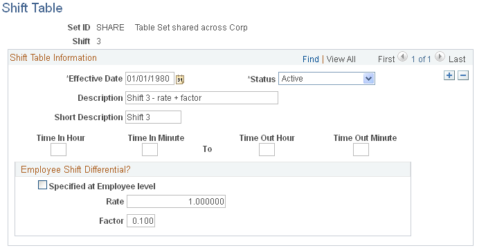

Use the Shift Table page (SHIFT_TABLE) to define a shift.
Navigation:
This example illustrates the fields and controls on the Shift Table page.
Shift Table Information
Field or Control  |
Description  |
Time In Hour, Time In Minute, Time Out Hour, and Time Out Minute  |
 The time format uses a 24-hour clock. To define a second shift from 4 p.m. to 11:59 p.m., enter 16, 00, 23, and 59. These fields are for your information only.  |
Employee Shift Differential?
Field or Control  |
Description  |
Specified at Employee level  |
 Select this check box if shift premiums vary from employee to employee within the shift and setID. This option enables you to define the shift premium rate or factor for any employee assigned to the shift at the employee level on the Job Information page.  |
Rate and Factor  |
 If you deselect the Specified at Employee level check box, enter the shift differential as a rate (flat amount), a factor (percentage), or both. Note: If you enter a rate or factor, it applies to all employees assigned to that shift. You cannot override these definitions at the employee level.  |
