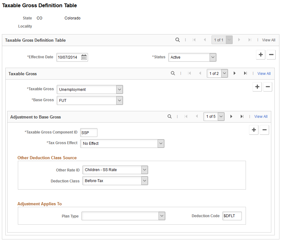

Use the Taxable Gross Definition Table page (TAXGR_DEFIN_TBL) to set up a taxable gross definition, which defines the taxability and withholding for specific earnings or deduction types that must be treated differently at the state or local level than at the federal tax level.
Navigation:
This example illustrates the fields and controls on the Taxable Gross Definition Table page.
Taxable Gross
Field or Control |
Description |
Taxable Gross |
Select the type of taxable gross you're defining. Valid values are: Disability Paid Leave Unemployment Withholding |
Base Gross |
Select: All Gross Note: When Taxable Gross is Paid Leave and the Base Gross is All Gross, the gross wages paid in the employee’s check will be the base when determining the taxable gross that is used to calculate the paid leave taxes. At this time, Washington is the only state that requires employee deductions and employer contributions for the paid family leave to be calculated on all gross wages. FUT (Federal Unemployment Tax) for unemployment, disability, or paid leave. FWT (Federal Withholding Tax) for withholding. FICA (Federal Insurance Contributions Act) for disability. |
Adjustment to Base Gross
This scroll area lists the specific components for which adjustments are necessary.
Field or Control |
Description |
Taxable Gross Component ID |
The taxable gross component ID you specify must be unique in what it represents (for example, 401k, GTL, 125, SSS, and so forth). If it is not unique, it can cause the taxable grosses to be incorrect. |
Withholding Follows Federal Rules |
This check box is selected by default. Deselect it if the withholding associated with the taxable gross component ID does not follow the same rules as federal withholding. This check box appears only if you select Withholding in the Taxable Gross field. This check box applies only to earnings and taxable benefit amounts identified by a taxable gross component ID. It has no effect on the processing of any before-tax deductions (such as 401(k) and Sec 125 amounts) for which there may also be entries on the Taxable Gross Definition table. |
Tax Gross Effect |
This field controls the effect on the gross. It can either add to the gross, subtract from it, or have no effect. |
Plan Type and Deduction Code |
Some states do not recognize certain before-tax benefits deductions. They require specific before-tax deductions to be included in taxable gross wages. Use these fields to identify such plans to the system by plan type and deduction code on the Taxable Gross Definition record for the applicable states. |
