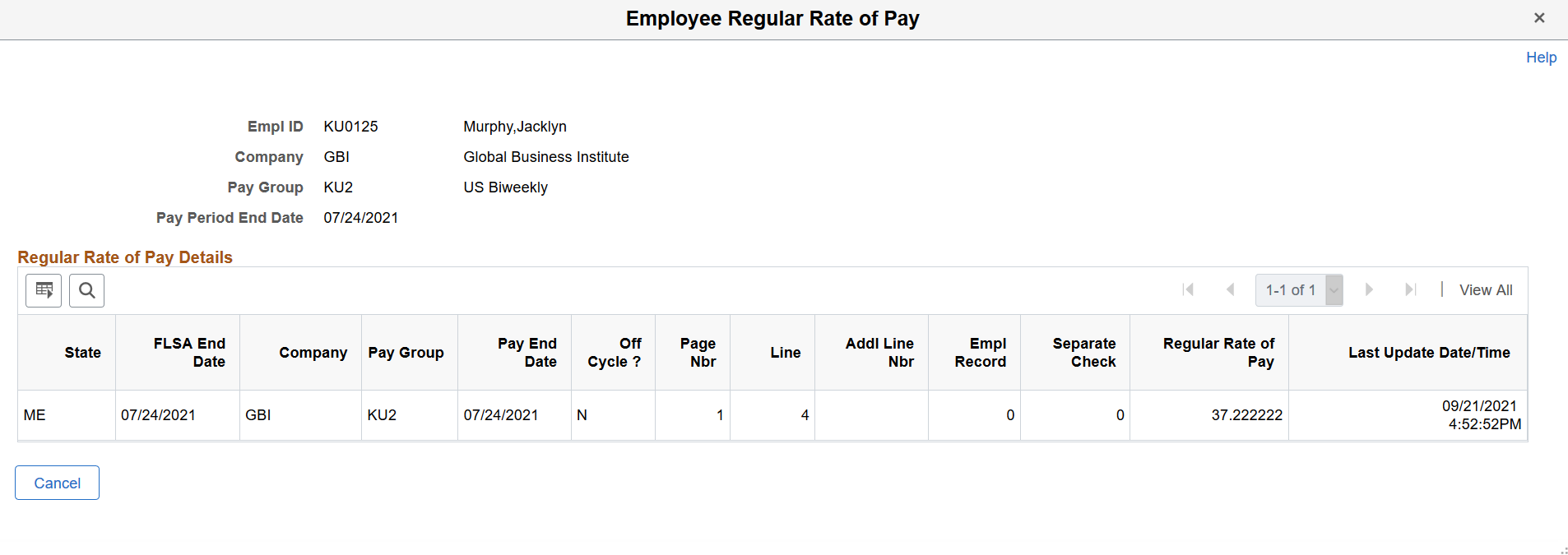

The system calculates the employee's regular rate of pay because the number of total hours worked exceeds 40. The regular rate of pay is calculated by dividing the total earnings for the week by the total hours worked, which is 37.22 USD.
This example illustrates the calculated regular rate of pay for the FLSA period on the Employee Regular Rate of Pay page (example 2).

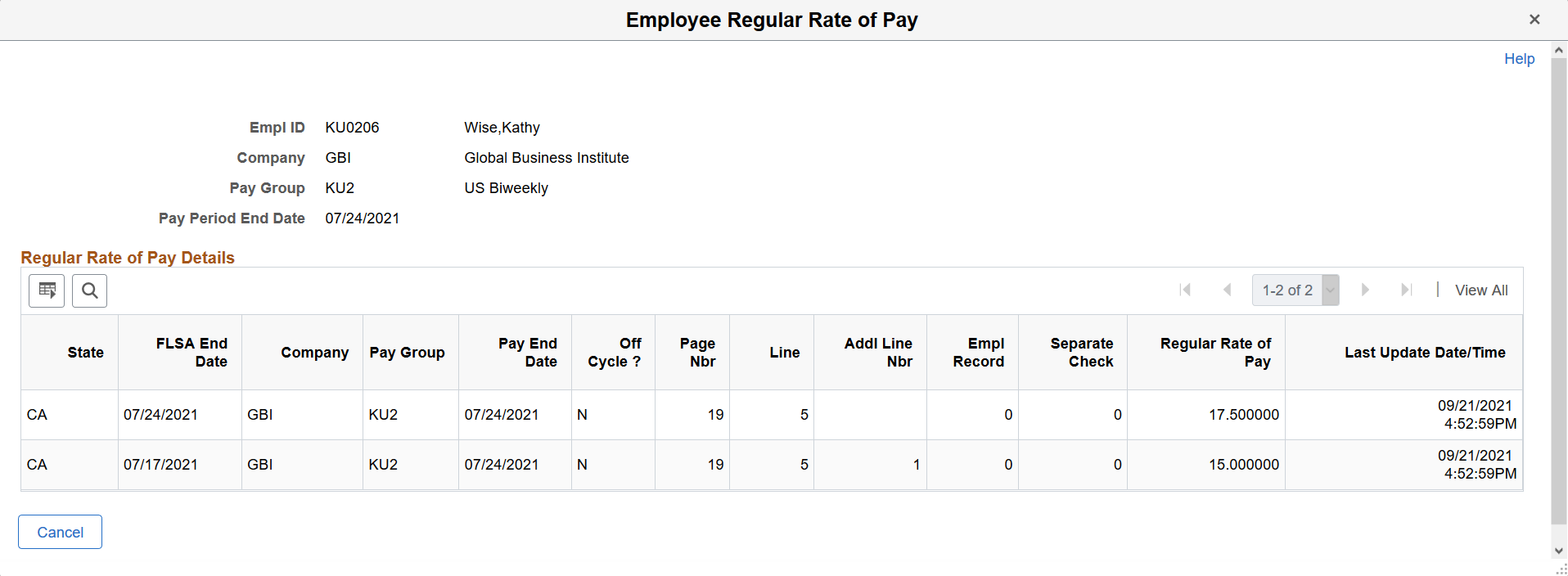

Even though the number of total hours worked doesn't exceed 40, the system calculates the employee's regular rate of pay because the 40-work-hour rule doesn't apply when the state is specified in the alternative overtimes state table and the employee is in the right FLSA status. In the first week's example, the calculated regular rate of pay is 15 USD, same as the hourly rate.
                                     Pay Information  |
                                     Value  |
                                     Current Pay Period  |
                                     July 11, 2021 – July 24, 2021  |
                                     FLSA Period  |
                                     July 18, 2021 – July 24, 2021  |
                                     State  |
                                     CA  |
                                     Calculation Routine for State  |
                                     Standard Calculation  |
                                     Hourly Rate  |
                                     15 USD  |
                                     Regular Hours  |
                                     40  |
                                     Bonus  |
                                     100 USD  |
                                     Total Earnings for the Week  |
                                     15 USD x 40 + 100 USD = 700 USD  |
                                     Regular Rate of Pay  |
                                     700 USD / 40 = 17.50 USD  |
In the second week's example, the employee had a 100 USD bonus and the calculated regular rate of pay is 17.50 USD.
This example illustrates the calculated regular rates of pay for both FLSA periods on the Employee Regular Rate of Pay page (example 3).

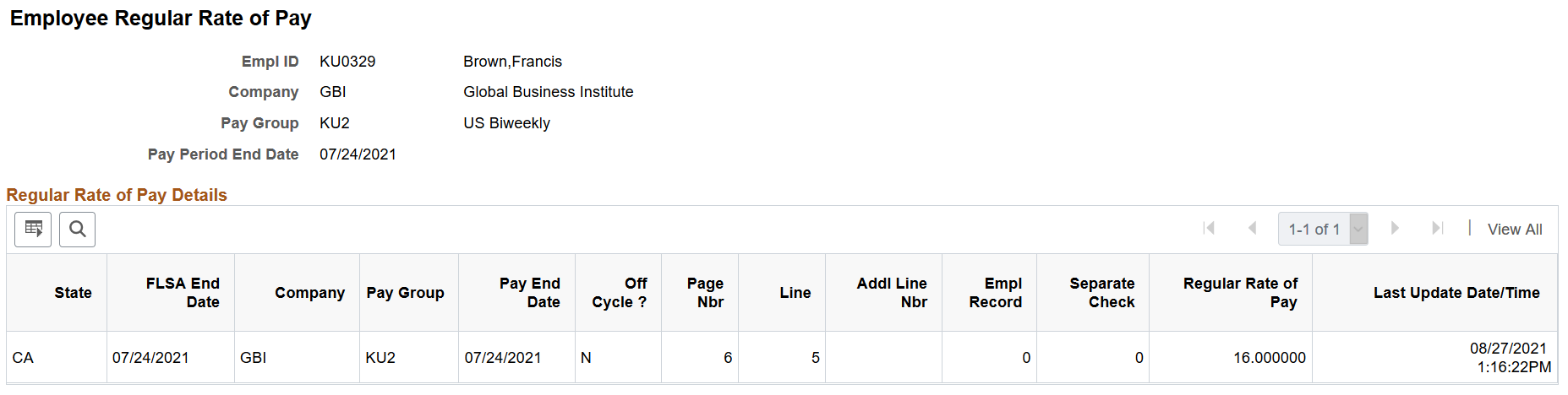

The regular rate of pay is calculated by adding the hourly rate and overtime premium, which is 18.50 USD.
This example illustrates the calculated regular rate of pay for the FLSA period on the Employee Regular Rate of Pay page (example 4).

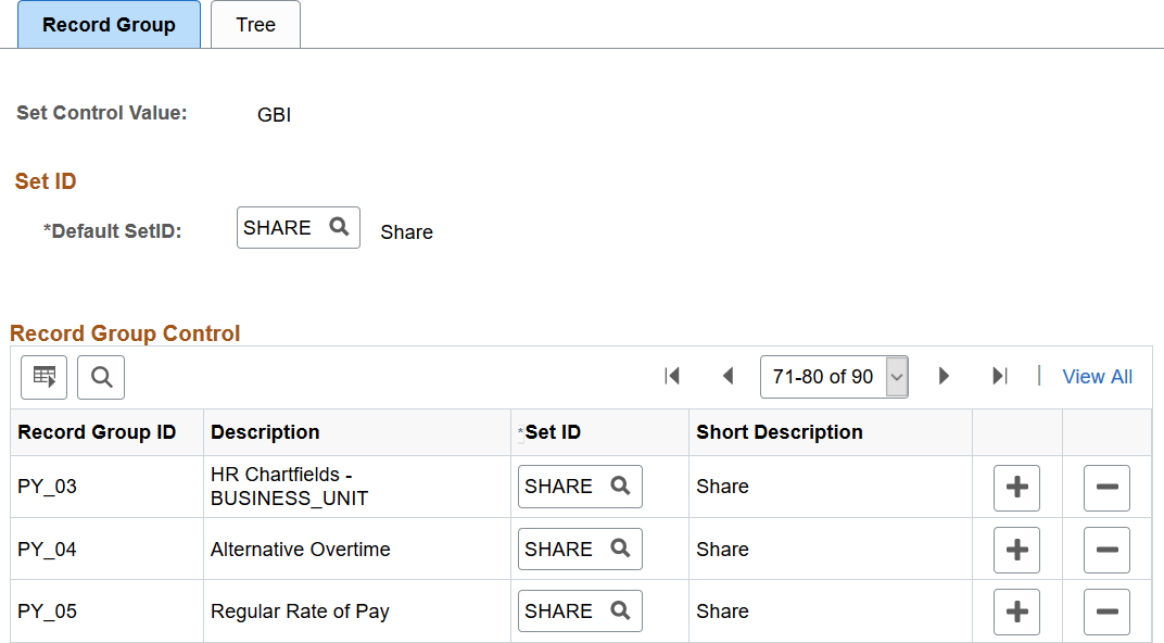

Select an setID for the PY_05 record group on the Record Group page (SET_CNTRL_TABLE1) to match the setID that you use for the regular rate of pay setup on the Regular Rate of Pay Control Page.
This example displays the record groups and their setIDs for GBI on the Record Group page. The setID for the PY_05 record group is SHARE, the same setID that is also used in the regular rate of pay setup.

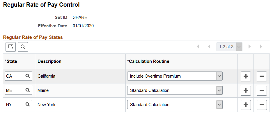

                    Specify the states that require employees’ regular rate of pay to be calculated for non-overtime pay and the applicable calculation routine on the Regular Rate of Pay Control Page. The Pay Calculation process uses the setID of the company on the payline to determine if the state needs the regular rate of pay calculation as of the earnings end date.
Use the Regular Rate of Pay Control page (PY_REG_RT_TABLE) to specify the states that require regular rate of pay calculation for non-overtime pay.
Navigation:
This example illustrates the fields and controls on the Regular Rate of Pay Control page.
            The SHARE setID is delivered as sample data showing the states that use the regular rate of pay to calculate non-overtime pay for non-exempt employees. This screenshot displays state information for illustration purposes. Update information on this page to support your organization's alternative overtime business rules.
