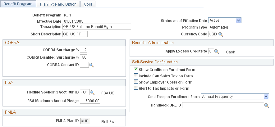

Use the Benefit Program page (BEN_PROG_DEFN1) to view a benefit program.
Navigation:
This example illustrates the fields and controls on the Benefit Program page.

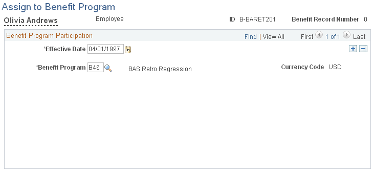

Use the Assign to Benefit Program page (BEN_PROG_PARTICPTN) to view the benefit programs in which an employee is enrolled.
Navigation:
This example illustrates the fields and controls on the Assign to Benefit Program page.
