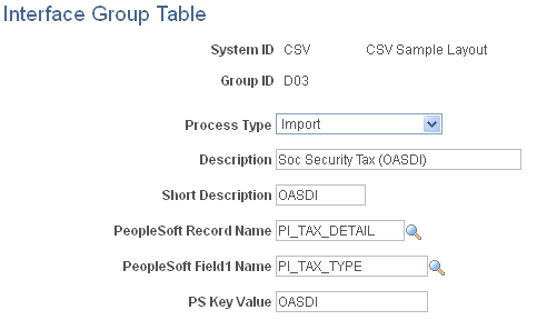

For physical file types, some data fields may be defined according to type (such as OASDI tax type) by their position in the import record. As shown in this example, Payroll Interface reflects this tax type by creating a separate row for each occurrence and captures the tax type during import by attaching a group ID:
This example of the Interface Group Table page shows a sample Group ID used for import.
As shown in this example of the Interface Group Table page Payroll Interface uses the entry in the PS Key Value (PeopleSoft key value) field to populate the field defined in PeopleSoft Field1 Name with OASDI, as it is builds the data for the record given by PeopleSoft Record Name from the import row being processed:

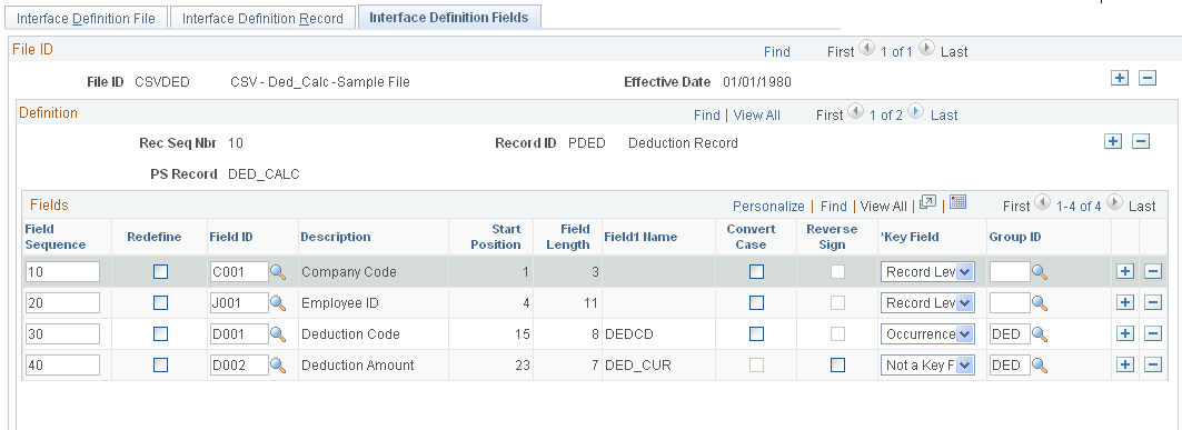

This example of the Interface Definition Fields page shows a sample interface definition used for import.

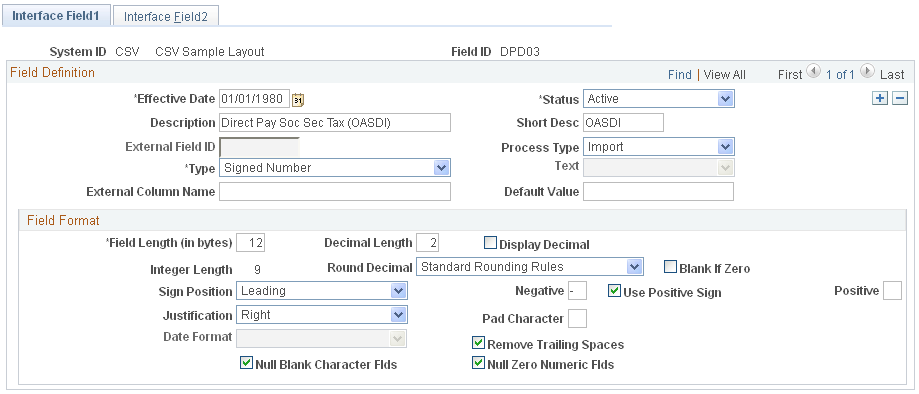

This example of the Interface Field1 page shows a sample field ID used for import.
As shown in this example of the Interface Field1 page group ID D03 is attached to the field ID DPD03.
