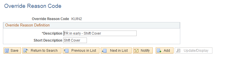

Use the Override Reason Code page (TL_OVRD_RSN_PNL) to define codes for the reasons for reporting or for changing reported time.
Navigation:
This example illustrates the fields and controls on the Override Reason Code page. You can find definitions for the fields and controls later on this page.
Enter comments and instances of reported time. When you enter comments, enter a reason code so that it will be easy to categorize the comments for reporting purposes. Use override reason codes for the Rapid Time and Time Reporting templates, and with the Timesheet page.
