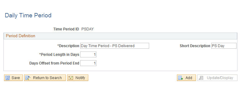

Use the Daily Time Period page (TL_FIXED_DAY_PNL) to establish a fixed day-type period when building time period calendars.
Navigation:
This example illustrates the fields and controls on the Daily Time Period page. You can find definitions for the fields and controls later on this page

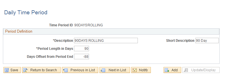

Example: Creating a Rolling Period with Negative Offset Days
The following page illustrates how to define the offset to create a 90-day, rolling period.
This example illustrates the fields and controls on the Daily Time Period page. You can find definitions for the fields and controls later on this page.
To create a rolling period, the negative offset (the value of the Start Offset from Period End field) should be two less than the length of the rolling period, which in this example would be 90 − 2 (-88). If you attempt to use -89, the system will generate the following error message: "Invalid Value for Offset." The system starts the new period by counting backwards from the day before the end date of the first period. If your first period instance were January 1, 2006 to March 30, 2006, the system would subtract 89 days, beginning from March 29, which would start the next period on January 1. To be a rolling period, the next instance of time should begin one day after the first period instance.

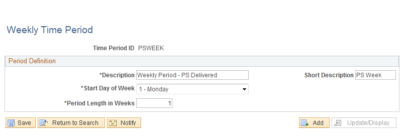

Use the Weekly Time Period page (TL_FIXED_WEEK_PNL) to establish weekly periods of time when building time period calendars.
Navigation:
This example illustrates the fields and controls on the Weekly Time Period page. You can find definitions for the fields and controls later on this page.
Enter the period length in weeks and select a start day for the week.

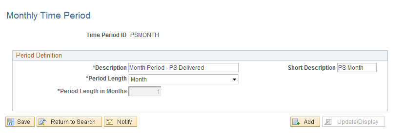

Use the Monthly Time Period page (TL_FIXED_MNTH_PNL) to establish monthly periods of time when building a time period calendar.
Navigation:
This example illustrates the fields and controls on the Monthly Time Period page. You can find definitions for the fields and controls later on this page.
Field or Control |
Description |
Semi-month |
Select semi-month for the period length to be 15 days. |
Semi-year |
Select semi-year for your period length to be 6 months. |
User Defined |
If you select User Defined, the Period Length in Months field becomes available. Enter the length of the period in months. The maximum number of months you can enter is 999, and the minimum number is 1. |
Note: When you define a type other than a user-defined month period, the system displays the number of days contained within the period.

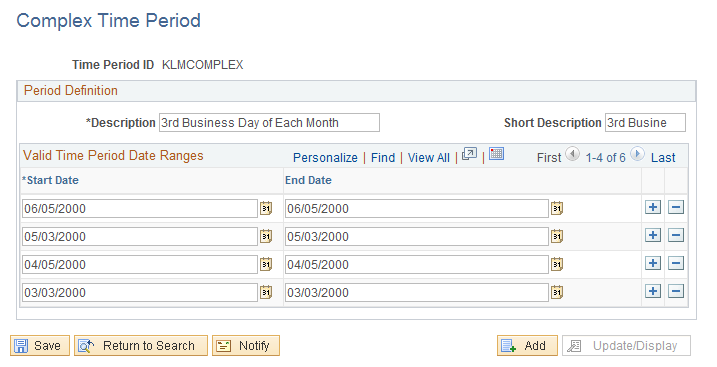

Use the Complex Time Period page (TL_COMPLEX_PNL) to establish complex periods of time when building a time period calendar.
Navigation:
This example illustrates the fields and controls on the Complex Time Period page. You can find definitions for the fields and controls later on this page.
Use this page for periods that cannot be defined by other period definitions.
Use the fields on this page to enter a start and end date for the time period.
Note: Complex periods are not created through the standard calendar build process; instead, they are created manually when you define the period on this page.

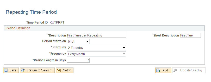

Use the Repeating Time Period page (TL_REPEATING_PNL) to establish repeating periods of time when building a time period calendar.
Navigation:
This example illustrates the fields and controls on the Repeating Time Period page. You can find definitions for the fields and controls later on this page.
Field or Control |
Description |
Period starts on |
Repeating periods can be defined in any number of ways. To define a repeating period, follow these steps:
To ensure that you have the expected results, check the time period calendar by selecting the View Time Period Calendar page after building the period using the Build Time Period Calendar process. |
Period Length in Days |
Enter the number of days in your period. The maximum you can enter is 999. |
