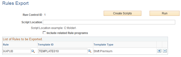

Use the Rules Export page (TL_EXP_RULE) to lists all of the rules that are to be exported from a source database and initiates the processes that select the listed rules and create a DataMover DAT file for exporting the rules.

This example illustrates the fields and controls on the Rules Export page. You can find definitions for the fields and controls later on this page.
Field or Control |
Description |
Include related Rule programs |
Select this check box to include the most current effective-dated rows for the Rule Programs associated with the selected rules in the export file. If you do not select this field, then you must manually associate each imported rule to the corresponding rule program. |
Create Scripts |
Click to perform the following steps:
Run |
Script Location |
Enter the location used by the system to store the DataMover scripts and DAT file created by the Export process. |
Rule ID |
Enter a specific rule to include in the exported rules file. |
Template ID |
Enter a Rules Template name to select all of the rules associated with that template for export |
Template Type |
Select a Template Type to specify that all of the rules associated with all of the rules templates for the specified template type are selected for export. |

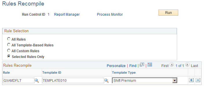

Use the Rules Recompile page (TL_RULE_RCMP) to recompile rules in the database.

This example illustrates the fields and controls on the Rules Recompile page. You can find definitions for the fields and controls later on this page.
Field or Control |
Description |
Recompile All Rules |
Select to recompile all existing rule templates. Clearing this check box enables you to view the Rules Recompile region of the page. |
Rule ID |
Enter a specific rule to recompile. |
Template ID |
Enter a Rules Template name to select all of the rules associated with that template for recompiling |
Template Type |
Select a Template Type to specify that all of the rules associated with all of the rules templates for the specified template type are recompiled. |
