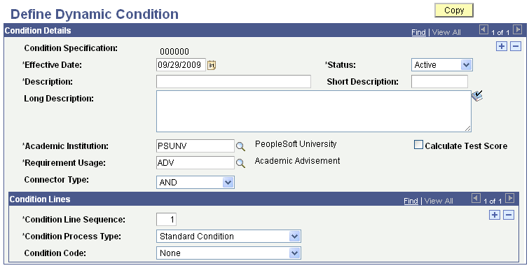

Access the Define Dynamic Condition page (
).The appearance and functionality of this page changes, depending on whether you access it in Add mode or Update/Display mode.
This example illustrates the fields and controls on the Define Dynamic Condition page: Add mode. You can find definitions for the fields and controls later on this page.
A condition specification (dynamic condition) is a condition that includes connector types, lines, process types, parameters, and controls. Once you create a condition specification, it may be referenced as a precondition or condition requirement by academic and enrollment requirements, as well as academic and enrollment requirement groups. It may also be referenced by another dynamic condition. Using Boolean logic, dynamic conditions can be combined within a condition specification to create complex expanded conditions. For example, you could create two dynamic conditions, and then point to these from a third dynamic condition. Dynamic condition #1 equals academic level = freshman and cum GPA>=2.0. Dynamic condition #2 equals sophomore and cum GPA>=2.5. Dynamic condition #3 equals dynamic condition #1 OR dynamic condition #2.
Field or Control |
Description |
Condition Specification |
This arbitrary number is unique for each condition specification. You can use this condition specification as a precondition or as a condition requirement. |
Effective Date |
The latest effective date that you entered for the condition specification is used during analysis. |
Description |
Enter a description for the condition specification that you want to establish. The description appears in the requirement group and requirement summaries, the advisement requirement report, the advisement requirement group report, and the reverse engineering report. When the dynamic condition is used as a condition in an academic requirement or academic requirement group, and if print controls dictate, the description prints on the advisement report, .pdf, and advisement transcript. The exception to this for the advisement report and .pdf is if the Condition Description field on the requirement's line item detail is populated. In that case, the condition description appears on the advisement report and .pdf. |
Short Description and Long Description |
Enter descriptions for the condition specification that you want to establish. These descriptions are used for documentation purposes only. |
Academic Institution |
Select the academic institution. Each condition specification is associated with only one academic institution. |
Requirement Usage |
Select the requirement usage that is relevant to the dynamic condition. A dynamic condition can be used only in requirement groups and requirements that share the same usage value. |
Connector Type |
Select the main connector type for this condition specification. Values are: None, AND, and OR. (None converts to AND). The connector type indicates the Boolean operator to be used in the equation that contains the condition lines. |
Condition Line Sequence |
This number indicates the order in which the condition lines are evaluated. The condition line sequence number is automatically assigned, but it the user can override it. |
Condition Process Type |
Select a condition process type. Values are: Standard Condition: Indicates that the condition is one of the delivered, standard conditions. This is the default field value. If you use this type, then the condition code field is available. User Programmable Condition: Indicates that the condition is a user programmable condition. If you select User Programmable Condition, the Condition Process Identifier field becomes available. |
Condition Code |
If you select the Condition Process Type field value of Standard Condition, then select one of the following delivered translate values: None: Indicates no field value. Academic Level: Indicates the year of study. For example, valid values include freshman and sophomore. This value is evaluated against the student based on whatever As of Date field value is specified at run time. Academic Plan: Indicates the area of study, for example, a major or minor within the academic program. Some plans are subdivided into sub-plans. Academic Plan and Primary Academic Plan reference the exact same plan when the student has one plan only. Academic Plans: Indicates that all of a student's plans are part of the equation. Academic Program: Indicates the program of study to which a student applies and is admitted. Academic Program and Primary Academic Program reference the exact same program when the student has one program only. Academic Programs: Indicates that all of a student's academic programs are part of the equation. Academic Standing: Indicates a student's standing at the institution. For example, values might include good standing, probation, and dismissal. You define values in the Academic Standing table. This value is evaluated against the student based on the as of date that you specify at run time. Academic Sub-Plan: Indicates a further specialization within the academic plan. Academic Sub-Plans: Indicates that all of a student's sub-plans are part of the equation. Cumulative Grade Point Average: A student's cumulative grade point average (derived from the students term history cumulative statistics, in conjunction with the processing as of date). Dynamic Condition: Indicates a dynamic condition that has been previously created in the Define Dynamic Condition component. Primary Academic Plan: Indicates a student's primary academic plan. The primary academic plan is designated by the lowest plan sequence number on the Student Plan page. For example, under a program of LAU, a student might have two plans, Psychology and Classics Minor. If Psychology has a plan sequence number of 10 and Classics Minor has a plan sequence number of 20, then Psychology is the primary academic plan. On the Student Plan page, student career number 0 is the primary career. Important! The primary academic plan is designated by the lowest plan sequence number on the Student Plan page, and the primary academic program is designated by the lowest career sequence number on the Student Program page. However, when a student has multiple programs (containing multiple plans), the primary academic plan is not necessarily the lowest plan sequence number under a given program, but it is that plan with the lowest plan sequence number under the program with the lowest student career number. For example, under a program of Liberal Arts Undergraduate (attached to a student career number of 0), a student has a plan of Psychology with a plan sequence number of 10. The same student has a plan of Art with a plan sequence number of 10 under a program of Fine Arts Undergraduate (attached to a student career number of 1). Both plans have a plan sequence number of 10, but the plan under the program with the lowest career number is the primary plan. In this example, the primary plan is Psychology, which is tied to a student career number of 0 through the Liberal Arts Undergraduate program. Primary Academic Program: Indicates a student's primary academic program. The primary academic program is the program designated by the lowest career sequence number. On the Student Program page, student career number 0 is the primary career. Student Group: Indicates a grouping of students. For example, values might include athlete and veteran. You define values in the Student Group table. Student Groups: Indicates that all of the student groups containing a student are part of the equation. Test Score: Select to use a test score as a condition. If you select this field value, the following additional fields appear: Test ID, Test Component, Condition Operator, Test Score, Months Valid, and Test Score Method. Months Valid and Test Score Method are editable according to the setup on the Define Tests for Advisement page. If you select User Programmable Condition, the Condition Process Identifier field becomes available. Select the appropriate value that is a unique, arbitrary number for the condition process. Values are: 0001 (Milestone Check), 0002 (Internal Degree Check), and 0003 (External Degree Check). Milestone Check verifies whether a milestone is completed, in progress, or not completed. Internal Degree Check verifies whether a student has received a degree from the home institution. External Degree Check verifies whether a student has received a degree from another institution. Note: You can create additional condition process identifier field values in the Condition Processes table. Delivered field values are numbered from 1 through 500. Client-added values should be numbered above 500. |

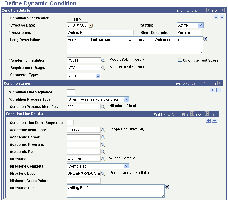

This example illustrates the fields and controls on the Define Dynamic Condition page: Update/Display mode. You can find definitions for the fields and controls later on this page.
If you select the Condition Process Type of User Programmable Condition, and the Condition Process Identifier of Milestone Check, then additional fields become available. Use these to specify the details about the milestone for use in this dynamic condition.
Field or Control |
Description |
If applicable, enter the academic institution. Each condition line detail is associated with only one academic institution. |
Academic Career |
If applicable, enter the academic career that contains the academic program that is associated with this condition line detail. |
Academic Program |
If applicable, enter the academic program that is associated with this condition line detail. |
Academic Plan |
If applicable, enter the academic plan that is associated with this condition line detail. |
Milestone |
Enter the milestone that must be achieved to satisfy this condition line detail. For example, a milestone could be an audition, qualifying exam, or thesis. You define milestones in the Milestone table. |
Milestone Complete |
Select the appropriate milestone. Values are: None: Indicates that the field is not applicable. Completed: Indicates that the student must complete this milestone to satisfy the condition line detail. In Progress: Indicates that the student must be working towards completing the milestone to satisfy the condition line detail. Not Completed: Indicates that the student must not have completed this milestone to satisfy the condition line detail. |
Milestone Level |
Enter the minimum level for this milestone. Some examples of milestone levels are honors, undergraduate, or graduate. |
Minimum Grade Points |
Enter the minimum grade points that are acceptable to complete this condition line detail. |
Milestone Title |
Enter a descriptive phase as the milestone title. This field does not appear on the advisement report or advisement transcript. Use this field for documentation purposes only. |
