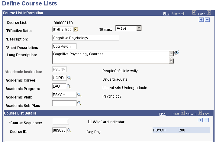

Access the Define Course Lists page ().
This example illustrates the fields and controls on the Define Course Lists page (1 of 2). You can find definitions for the fields and controls later on this page.
Academic course lists are the principal component of the Program Guide. They list courses or wildcard courses. Requirements use course lists to identify the courses that a student must select from to complete a degree requirement. You specify courses using either a unique course ID or the wildcard indicator. For example, you can insert a row with the course ID for English 62 or set up a wildcard course list of all English courses. The alternative would be to manually enter each English course, row by row.
Course List Information
Field or Control |
Description |
Course List |
If you did not specify a unique identifying number when you created the requirement, then the system assigns a number upon saving and the number appears here. |
Effective Date |
Enter an effective date to define when the status that you select is valid. This date reflects the student's requirement term as determined by the requirement group that uses this course list. The requirement term begin date of the requirement group academic structure determines which effective-dated course list row is current for the student. For example, if you define a requirement group to the plan level, then the system uses the student's plan requirement term to determine the effective date for the requirement group. (You assign requirement terms in the Student Program/Plan component.) The system then uses this requirement term to evaluate the current effective-dated row for all requirements and course lists that the requirement group uses. For another example, suppose that a requirement group is defined at a program level. The requirement group has two effective-dated rows, 01/01/1900 and 01/01/2000. The student's academic program requirement term is fall 1999, so the current effective-dated row for the requirement term of fall 1999 is 01/01/1900. The 01/01/1900 requirement group points to a requirement with effective-dated rows of 01/01/1900 and 01/01/1980. Again, the student's program requirement term is used (because that was the academic structure of the requirement group that uses this requirement), and the current effective-dated row for requirement term fall 1999 is now 01/01/1980. The 01/01/1980 requirement uses a course list with two effective-dated rows of 01/01/1900 and 01/01/1990. Once again, the student's program requirement term is used to evaluate the current effective-dated row to be used, which in this case would be 01/01/1990. |
Description, Short Description, and Long Description |
Enter descriptions that will be useful to those who maintain the course lists and corresponding requirements and requirement groups. The descriptions are used primarily for searching. None of these values appears on the Program Guide advisement report. |
Academic Institution, Academic Career, Academic Program, Academic Plan, and Academic Sub-Plan |
These fields document departmental ownership of the course list. They are used for prompting and documentation only; they do not affect the auditing analysis. |
Fetch |
Click to retrieve and display the course sequence data for the effective-dated row. You can then add or modify courses in the course list. This button does not appear when you are in Add mode. |
Course List Details
Field or Control |
Description |
Course Sequence |
The system displays a sequence of numbers, and each sequence represents a course ID. The system assigns the numbers sequentially but you can change the sequence. The courses do not need to be in a particular order. They will appear on the report in alphabetical order by subject and by catalog number. For example, HIST 101, HIST 220, PHIL 100. |
Course ID |
Enter the course ID that specifies the course needed to satisfy this course list. You can prompt on this field and enter search criteria to narrow the selection choices. If a course ID contains multiple offerings, then any of the offerings attached to that course ID satisfies that course list. In addition, if a student takes two offerings in a course ID, then the audit allows both classes to count toward unit and grade point average (GPA) requirements. The classes are treated as separate courses. This field is not available if you select the WildCard Indicator check box. |
Wildcard Indicator |
Select to set up a wildcard course. When selected, additional fields become available on the page so that you can define the wildcard. |
Display Wildcard Courses |
The system displays this check box when the Wildcard Indicator check box is selected. Select this check box to display the wildcard courses in the course grid on the Program Guide advisement report. |
Subject |
The system displays this field when the Wildcard Indicator check box is selected. Enter the subject of the course offering. Leave this field blank if any subject is acceptable. The subject and catalog number appear in the Course column in the course grid of the advisement report. |
Catalog Nbr (catalog number) |
The system displays this field when the Wildcard Indicator check box is selected. Enter the required portion of the catalog number that is a 10-character field. Use the format NNNNAAAAAA, where the first four characters are numeric and the last six characters are an alphanumeric suffix. For example, a catalog number of 3## indicates that any 300-level course is acceptable, including 301A, because suffixes are ignored when a number wildcard is specified unless a suffix value is exclusively indicated. In another example, a catalog number of 3##B would accept only 300-level courses with a suffix of B. In a third example, a catalog number of 321* indicates that 321, 321A, and 321B, but not 321AB, are acceptable. You can use a wildcard in any position in the field. When you use wildcards, the system does not check equivalent courses as an efficiency constraint. A table is available which provides you with an overview of how the system processes different wild card values. See Creating a Course List Detail. Note: The Catalog Nbr field does not support ranges. However, you can establish multiple detail lines. For example, in one detail line, you can use a wildcard for 100-level courses. In a second detail line, you can use a wildcard for all 200-level courses. Use the # to represent the first four numeric values, and use the * to represent the last six alphanumeric characters. If you enter #, then the system right-justifies the value. If you enter *, then the system left-justifies the value. For example, 1#* retrieves the numbers 1 through 19 plus one alphanumeric character. |
Report Description |
The system displays this field when the Wildcard Indicator check box is selected. Enter a brief description of the wildcard course. This description appears in the Description column of the course grid on the Program Guide advisement report. |
