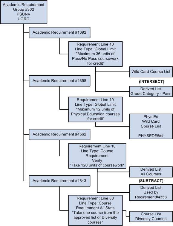

The following diagram displays an overview of how to set up a global sequential restriction requirement.
The diagram illustrates how to set up a global sequential restriction requirement.
