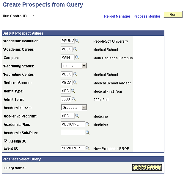

Access the Create Prospects from Query page ().
This example illustrates the fields and controls on the Create Prospects from Query page.

Select the default values to assign to the prospects that you create from the query. For example, if you select UGRD in the Academic Career field, the system assigns every prospect it creates to the undergraduate academic career. To create prospects, you must enter an academic institution, academic career, recruiting status, and recruiting center. In certain circumstances, you might also want to assign additional information, such as academic program and plan, and admit term, when your test load contains a specific set of prospects.
Access the Select Query page (Click the Select Query button on the Create Prospects from Query page).
