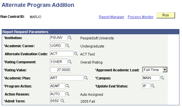

Alternate Program Addition |
RUNCTL_ADALTPRG |
Run the Alternate Programs process. The Alternate Programs process updates applications by comparing the minimum score that you enter on this page to the overall rating that the Evaluation Calculation process calculates. The Alternate Programs process uses the information that you define on this page to update information in the new application row. |
Access the Alternate Program Addition page ().
This example illustrates the fields and controls on the Alternate Program Addition page. You can find definitions for the fields and controls later on this page.

Field or Control |
Description |
Institution |
Enter the academic institution for which you want to run the process. |
Academic Career |
Enter the academic career for the alternate academic program. |
Alternate Evaluation Code |
Enter the alternate evaluation code that is assigned to the applicants to be evaluated. The Alternate Programs process updates the applications of only those applicants who have been assigned this alternate evaluation code. Therefore, you must have already run the Alternate Eval Code process to assign applicants an alternate evaluation code. Define alternate evaluation codes on the Evaluation Table page. |
Rating Component |
Enter the rating component that you want to use to evaluate applicants. The rating component defines the format and meaning of the rating value. For example, in the preceding page shot, you selected the ACT rating component. The rating value therefore represents the minimum ACT score that can be admitted into the alternate program. |
Rating Value |
Enter the minimum score for consideration in the alternate program. The Alternate Programs process compares this score to the overall rating value that the Evaluation Calculation process calculates. If the overall rating value is equal to or more than the value you enter in this field, then the applicant is accepted into the alternate program. In the above example, the applicant must score at least 27 on the ACT to be accepted into the alternate program. See Assigning Alternate Programs. Note: After an applicant is accepted into the alternate program, the Alternate Programs process creates a new row in the person's application (adm_appl_prog) for the existing application number. The system assigns a new program number for the new program and plan into which the person was accepted. |
Approved Academic Load |
Select the academic load that you want the process to assign to anyone who meets the criteria defined on this page. |
Academic Plan |
Enter the academic plan that you want the process to assign to anyone who meets the criteria defined on this page. |
Campus |
Enter the campus that you want the process assign to anyone who meets the criteria defined on this page. |
Program Action |
Enter the program action that you want the process assign to anyone who meets the criteria defined on this page. |
Update Eval Status (update evaluation status) |
Enter the evaluation status that you want the process to assign to anyone who meets the criteria defined on this page. |
Action Reason |
Enter the action reason that you want the process to assign to anyone who meets the criteria defined on this page. |
Admit Term |
Enter the admit term that you want the system to assign to anyone who meets the criteria defined on this page. |
In the above example, applicants to the undergraduate career at PSUNV with an alternate evaluation code of ACT and an ACT score of at least 27 will receive a program action of Admit.
Click Run to run the Alternate Programs process at user-defined intervals.

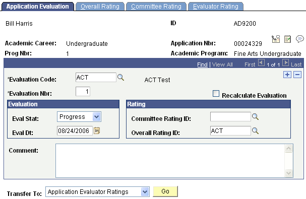

The Alternate Averages process assigns an alternate evaluation code (ACT) to the person's application, as illustrated in the following example. Access the Application Evaluation component by selecting .
This example is an example of Application Evaluation page.
Note in the page above that the evaluation code now reads ACT.
This new evaluation code has not been evaluated through the Evaluation Calculation process.

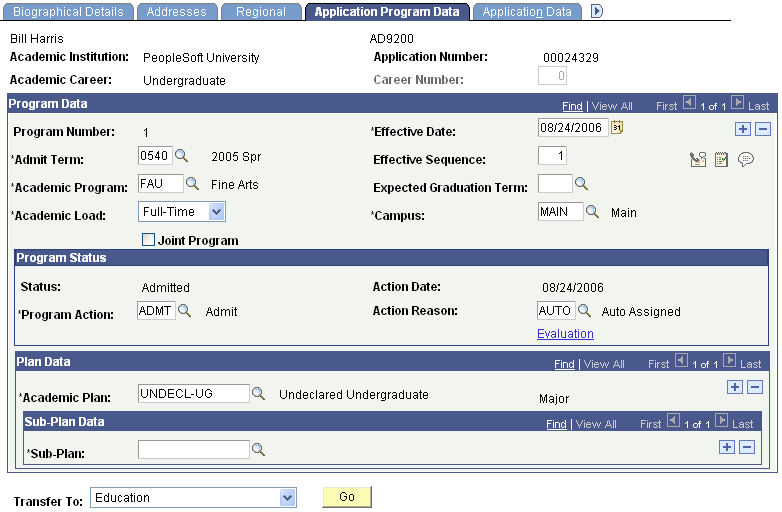

The applicant in our example was denied in his requested program (LAU), but was accepted into the alternate program (FAU), as illustrated in the following page shot. Maintain Applications is found by selecting
This is an example of Application Program Data page (2 of 2).
Note that the program number is now 1. The Alternate Programs process inserted a new row and incremented the program number by one. Thus, the program action of DENY for LAU still exists in the student's record. This new row contains the new academic program FAU (the alternate program) and note that the program action is ADMT. The Alternate Programs process also updated the remaining parameters that you selected on the Alternate Program Addition page, such as the action reason, campus, and academic load.
By evaluating this applicant in an alternate program, you were able to admit a person whom you would have otherwise denied.
