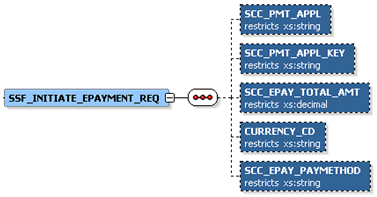

Input Message: SSF_INITIATE_EPAYMENT_REQ
This image shows the input parameters that the SSF_INITIATE_EPAYMENT service operation receives from an online application.
Required data that the online application must supply to the service operation:
Payment Application
Payment Application Key (Application Number)
Payment Amount
Currency Code
Payment Method (Credit card or electronic check)
The following is an example of the SSF_INITIATE_EPAYMENT_REQ message that the SSF_INITIATE_EPAYMENT service operation receives from an online application:
<?xml version="1.0"?>
<SSF_INITIATE_EPAYMENT_REQ xmlns="http://xmlns.oracle.com/Enterprise/HCM/services">
<SCC_PMT_APPL>SADAAWS</SCC_PMT_APPL>
<SCC_PMT_APPL_KEY>00024828</SCC_PMT_APPL_KEY>
<SCC_EPAY_TOTAL_AMT>20</SCC_EPAY_TOTAL_AMT>
<CURRENCY_CD>USD</CURRENCY_CD>
<SCC_EPAY_PAYMETHOD>CC</SCC_EPAY_PAYMETHOD>
</SSF_INITIATE_EPAYMENT_REQ>

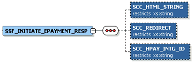

Output Message: SSF_INITIATE_EPAYMENT_RESP
When the Integration Broker receives the SSF_INITIATE_EPAYMENT_REQ message, it responds with the SSF_INITIATE_EPAYMENT_RESP message.
This image shows the output parameters that the SSF_INITIATE_EPAYMENT service operation passes to the online application.
The following is an example of the SSF_INITIATE_EPAYMENT_RESP message that the SSF_INITIATE_EPAYMENT service operation transmits to the online application:
<SSF_INITIATE_EPAYMENT_RESP xmlns="http://xmlns.oracle.com/Enterprise/HCM/services">
<SCC_REDIRECT>N</SCC_REDIRECT>
<SCC_HTML_STRING>
<![CDATA*<SCRIPT LANGUAGE='JavaScript'>
writeConsole('https://someserver/C30002test_upay/web/index.jsp', '<input type="HIDDEN" name="TICKET_NAME" value="SADAAWS"><input type="HIDDEN" name="UPAY_SITE_ID" value="12"><input type="HIDDEN" name="TICKET" value="ce224625-e55c-4346-b87c-96f784f5ae90">');
function writeConsole(bind1, bind2)
var stuff = '<form name="payform" action="'+bind1+
'" method="POST">'+bind2+'<SCRIPT LANGUAGE="JavaScript" onload="submitForm()">'+
'function submitForm(){document.payform.submit()}'+
'</'+'SCRIPT>'+'</'+'form'+'>';
document.body.innerHTML = stuff;
document.payform.submit();
</SCRIPT>*]>
</SCC_HTML_STRING>
<SCC_HPAY_INTG_ID>QA_CS_AAWS_MODEL1A</SCC_HPAY_INTG_ID>
</SSF_INITIATE_EPAYMENT_RESP>

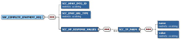

Input Message: SSF_COMPLETE_EPAYMENT_REQ
This image shows the input parameters that the SSF_COMPLETE_EPAYMENT service operation receives from an online application.
Hosted Payment Adapter ID.
Return URL Type (Success, Cancelled, Error).

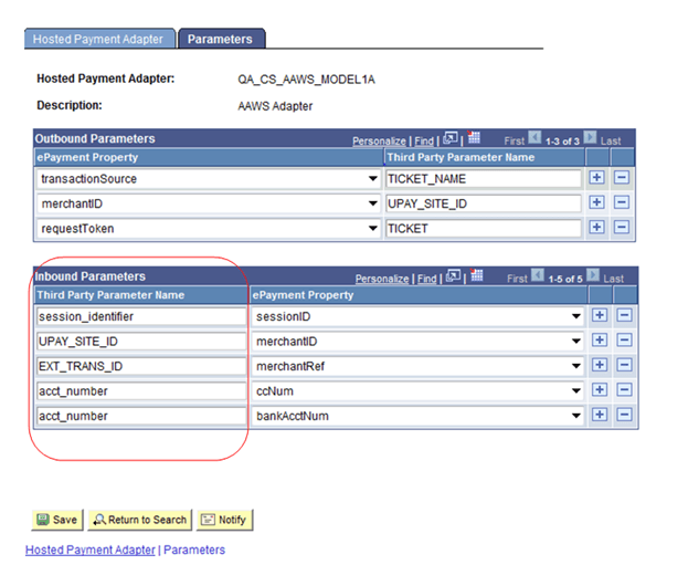

Hosted Payment Response Values (Name/Value pairs returned from third party). These values are expected to correspond to the values under the Third Party Parameter Name of Inbound Parameters grid of Hosted Payment Adapter Setting. For example:
This example illustrates a Hosted Payment Adapter setting.
The following is an example of the SSF_COMPLETE_EPAYMENT_REQ message that the SSF_COMPLETE_EPAYMENT service operation receives from an online application:
<SSF_COMPLETE_EPAYMENT_REQ xmlns="http://xmlns.oracle.com/Enterprise/HCM/services">
<SCC_EPAY_URL_TYPE>S</SCC_EPAY_URL_TYPE>
<SCC_HP_RESPONSE_VALUES>
<SCC_TP_PARM>
<name>session_identifier</name>
<value>5c012fb4-43a4-4ffd-be63-a1415ce2b7e4</value>
</SCC_TP_PARM>
<SCC_TP_PARM>
<name>UPAY_SITE_ID</name>
<value>12</value>
</SCC_TP_PARM>
<SCC_TP_PARM>
<name>EXT_TRANS_ID</name>
<value>SADAAWS_00024863</value>
</SCC_TP_PARM>
<SCC_TP_PARM>
<name>acct_number</name>
<value>XXXXXXXXX2222</value>
</SCC_TP_PARM>
<SCC_TP_PARM>
</SCC_TP_PARM>
</SCC_HP_RESPONSE_VALUES>
</SSF_COMPLETE_EPAYMENT_REQ>

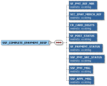

Output Message: SSF_COMPLETE_EPAYMENT_RESP
When the Integration Broker receives the SSF_COMPLETE_EPAYMENT_REQ message, it responds with the SSF_COMPLETE_EPAYMENT_RESP message.
This image shows the output parameters that the SSF_COMPLETE_EPAYMENT service operation passes to the online application.
The following is an example of the SSF_COMPLETE_EPAYMENT_RESP message that the SSF_COMPLETE_EPAYMENT service operation transmits to the online application:
<SSF_COMPLETE_EPAYMENT_RESP xmlns="http://xmlns.oracle.com/Enterprise/HCM/services">
<SF_PMT_REF_NBR>000000000043</SF_PMT_REF_NBR>
<SCC_EPAY_MERCH_REF>00024828</SCC_EPAY_MERCH_REF>
<CR_CARD_DIGITS>1111</CR_CARD_DIGITS>
<SF_POST_STATUS>S</SF_POST_STATUS>
<SF_PAYMENT_STATUS>B</SF_PAYMENT_STATUS>
<SSF_PMT_SOURCE_STATUS>S</SSF_PMT_SOURCE_STATUS>
<SSF_PMT_MSG>Your payment was successfully processed.</SSF_PMT_MSG>
<SSF_APPL_MSG>Your application 00024828 was successfully submitted.</SSF_APPL_MSG>
</SSF_COMPLETE_EPAYMENT_RESP>
